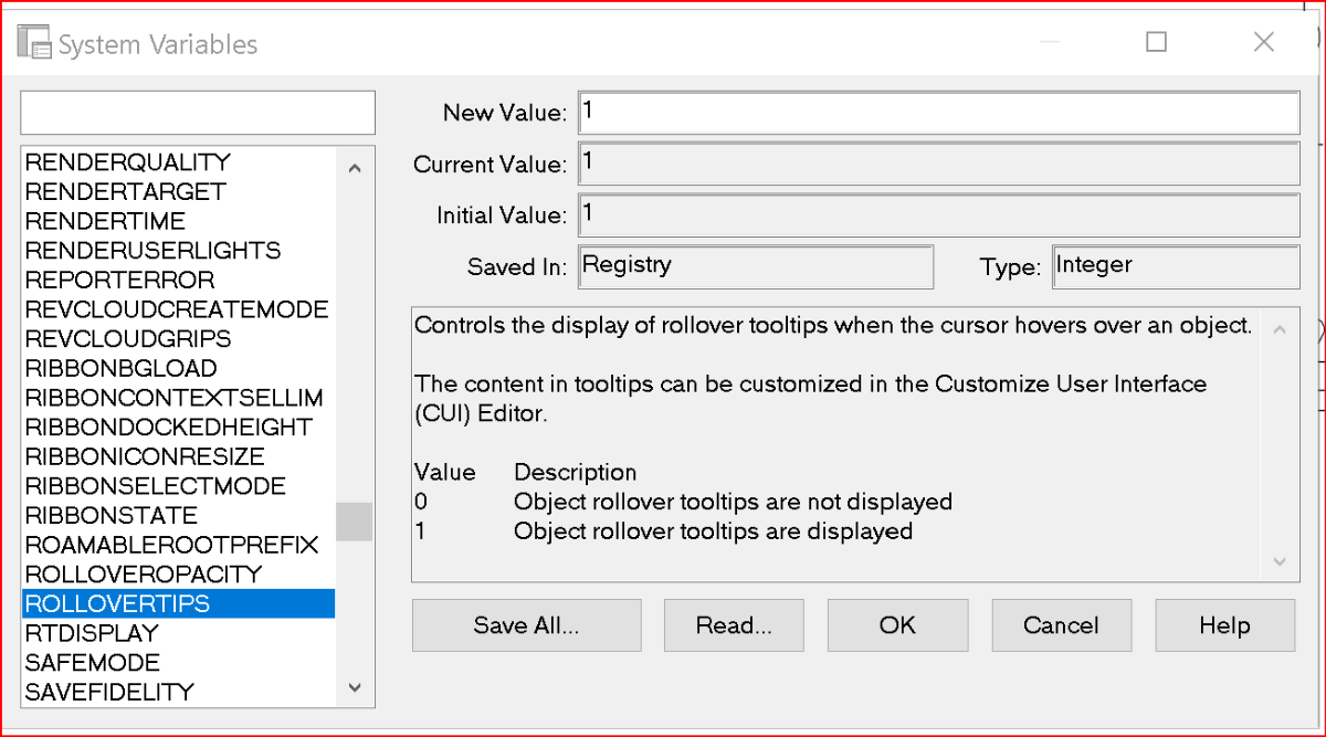

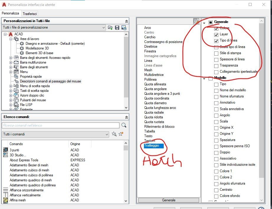

or just enter ROLLOVERTIPS at the command line and enter 0 and the cursor will never stick to anything again.
I already had it like this setting. Is this how I have to check, in which case the situation was already like this?

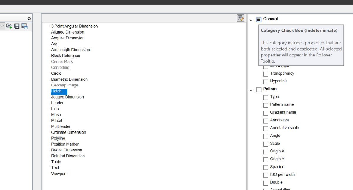

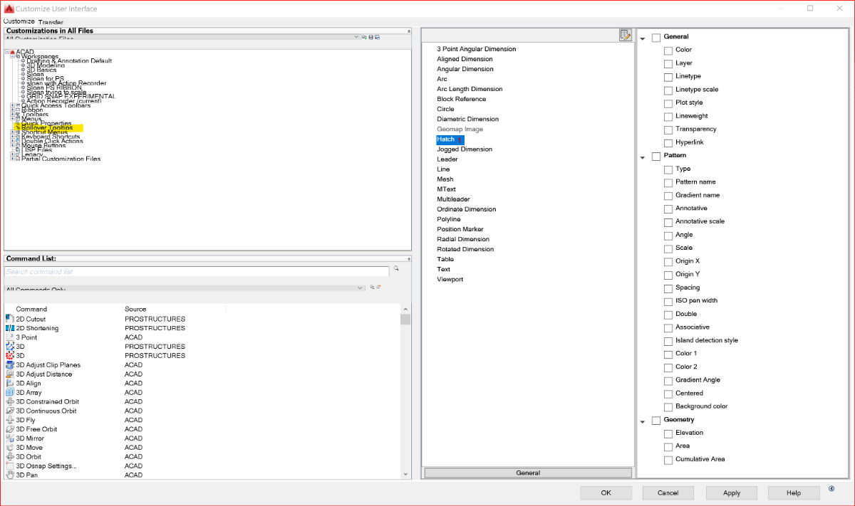

Pick "Generale" box so it isn't filled anymore so cursor will no longer stop on hatches anymore!
You appear to be on the page to which Tombu is referring, as per the screenshot.
Go to the top of the list on the right side, and DESELECT (turn off)   GENERAL, just like in the screenshot.  :|
That is, the box must be without flags, i.e. with white squares?
Yes!
Or just enter ROLLOVERTIPS at the command line and enter 0 and the cursor will never stick to anything again.

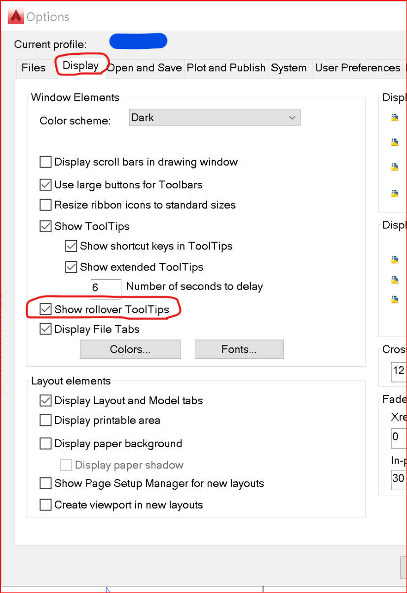

That system variable can also be found in OPTIONS on the DISPLAY tab
image.thumb.png.13148cd15aaffbebad37f35f426b24d9.pngimage.thumb.png.d72848b936b7521d84db5a3b02fc79a1.png
do I have to remove the flags, that is, do I have to leave the square blank?
Dadgad's suggestion: Options → [Display] tab → Uncheck "Display File Tabs"
is as easy as it gets and doesn't require using the CUI interface.
Graphics on our work PC's has always been sketchy so I've kept that turned off since it was introduced.

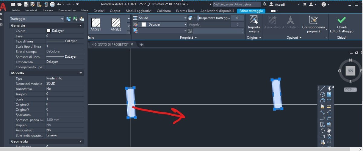

Ho deselezionato ho salvato. Ma non cambia nulla. Ad esempio, se voglio eliminare un tratteggio all'interno di un rettangolo, posiziono il mouse e si attacca. Trovo un miglioramento solo se, vado velocemente a fare l'operazione, cioè clicco sul tratteggio e clicco elimina, quindi sposto subito il mouse, tranne. Cosa posso fare? Grazie

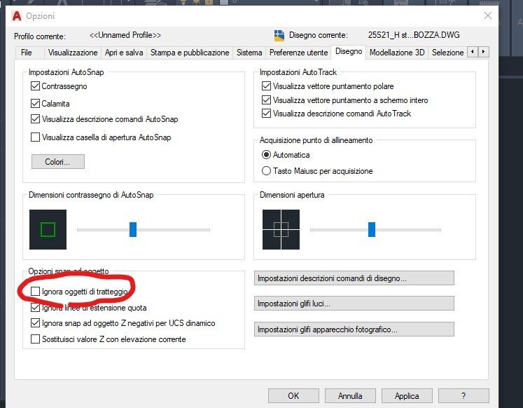

Did you ever go > OSOPTIONS, set to ignore Hatch Objects, easiest to do through Options-Drafting-Object Snap Options and select "Ignore hatch objects"?
That tick has already been removed ... nothing changes...
What about the rest of the questions?
I have deselected everything you asked me to deselect, but nothing changes?
