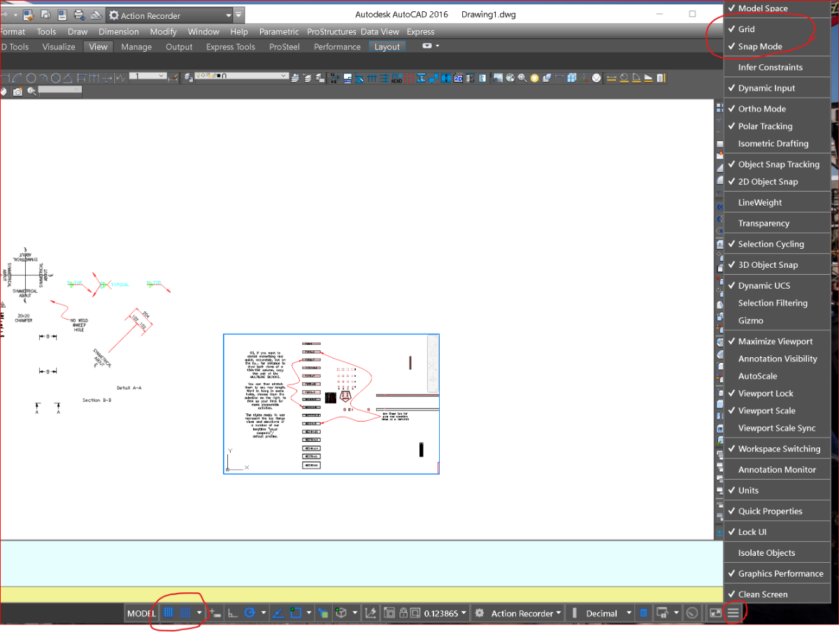

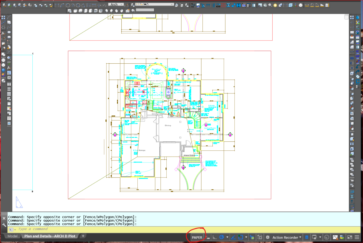

Dadgad Posted February 15, 2022 Posted February 15, 2022 (edited) That sounds pretty annoying. Try using VPMAX command, it might speed things up. I like having it available on my Status Bar, click on the Customization icon in the lower right corner to turn it on on your status bar. Edited February 15, 2022 by Dadgad a brain is a terrible thing to waste, screenshot added Quote
Giovannino60 Posted February 15, 2022 Author Posted February 15, 2022 I do not understand where this cmando can be met? Could you take me a screen shot of the whole screen? Then I did not understand if I activate this button how should I intervene, that is, click on the button and what should happen? Thank you Quote

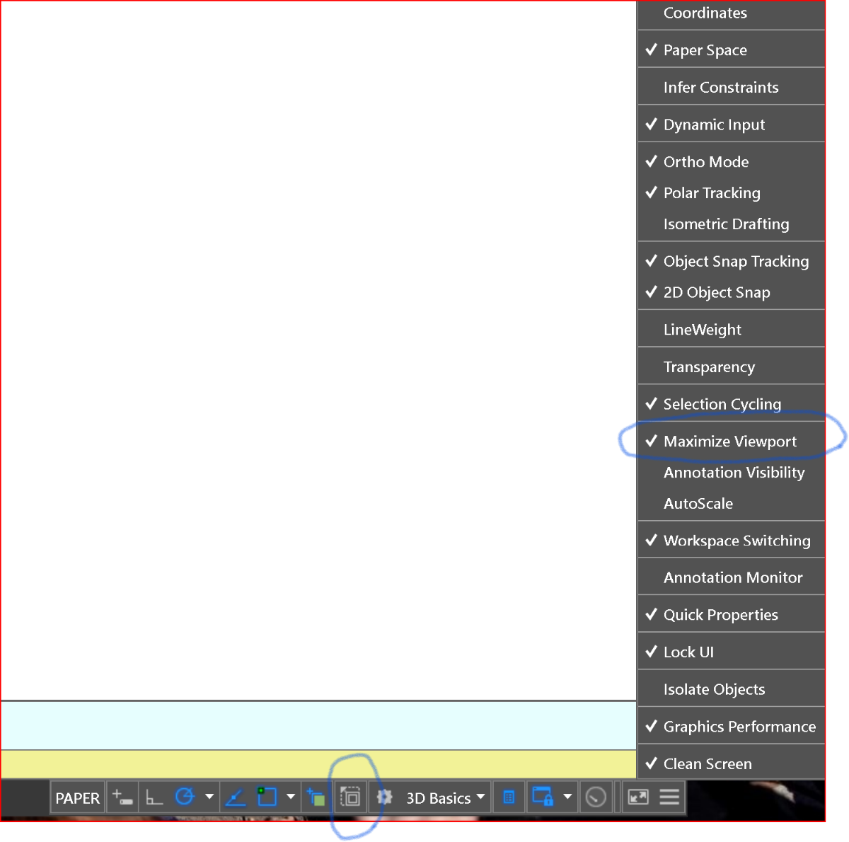

Dadgad Posted February 15, 2022 Posted February 15, 2022 Start in Paperspace. Just enter VPMAX at the commandline, then follow the commandline prompts. You will be asked to select a Viewport which you want Maximized. That will take you into ModelSpace, and I hope you will hit the ground running. When you want to go back to your layout in Paper Space use VPMIN command. Quote

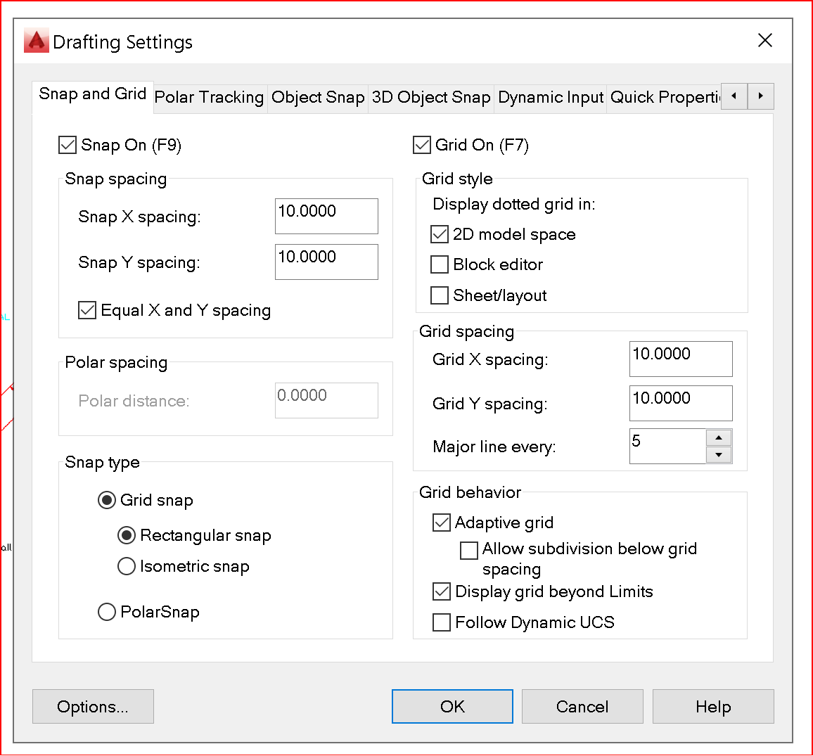

Dadgad Posted March 21, 2022 Posted March 21, 2022 Might you have GRIDSNAP or SNAPS turned on? Or possibly, too many (or all) of your OSNAPS turned on? You might also want to check your Drafting Settings Dialog. Quote

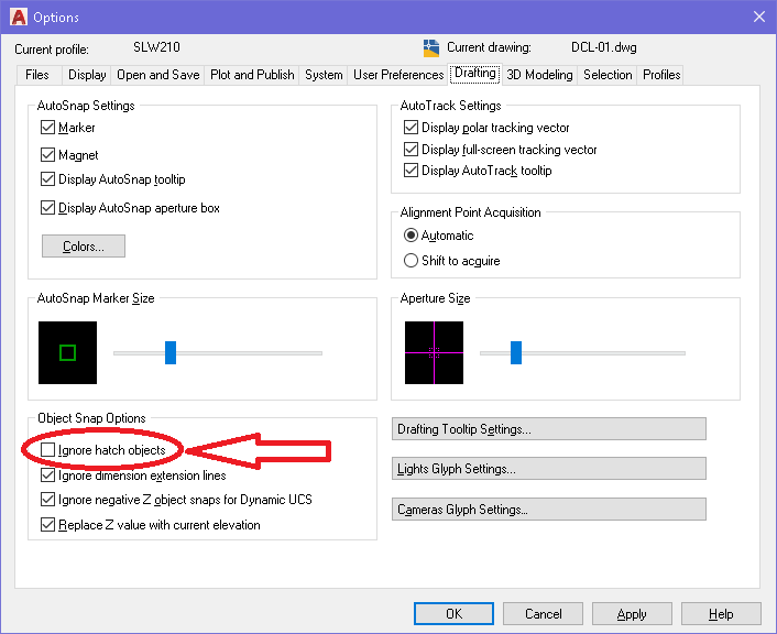

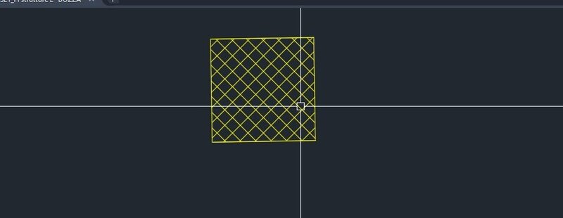

SLW210 Posted March 23, 2022 Posted March 23, 2022 OSOPTIONS, set to ignore Hatch Objects, easiest to do through Options-Drafting-Object Snap Options and select "Ignore hatch objects". As mentioned, mostly sounds like a computer issue. What OS are you using? Can you post a drawing with this problem, just to check? 2 Quote

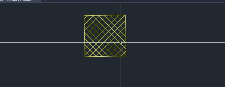

Dana W Posted March 27, 2022 Posted March 27, 2022 (edited) Aha, I should have seen that one. Of course, selection preview and large or multiple unseparated hatches will cause the cursor to have a seizure too. More than a month and nothing but more questions? I'm not checking back again. Edited March 27, 2022 by Dana W Quote

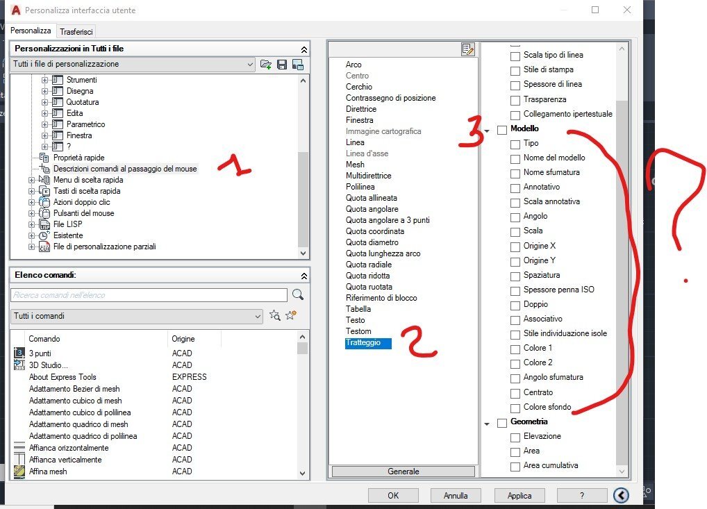

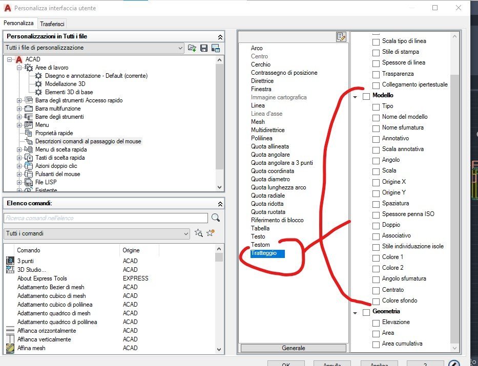

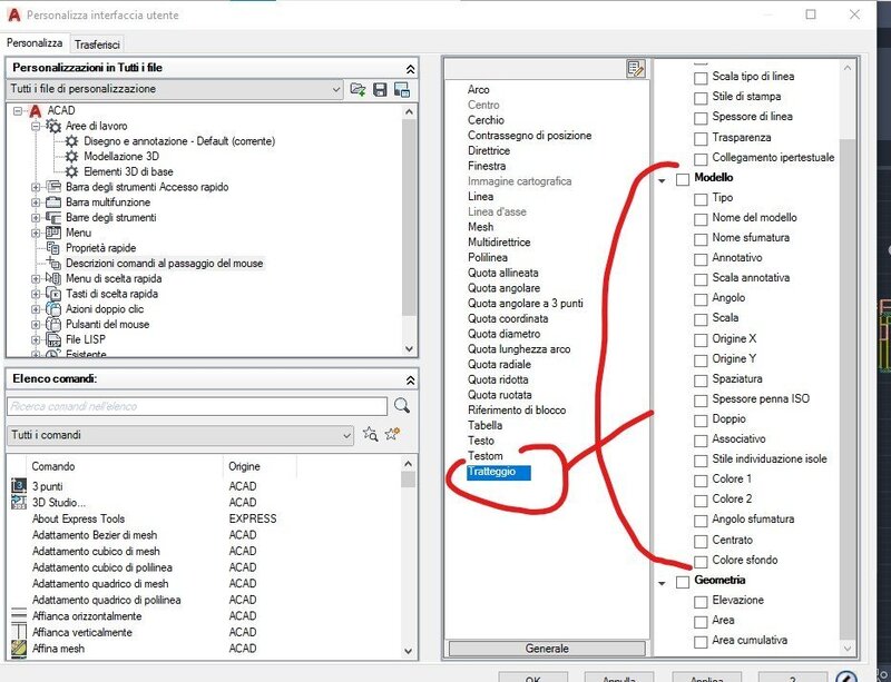

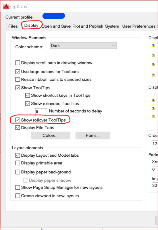

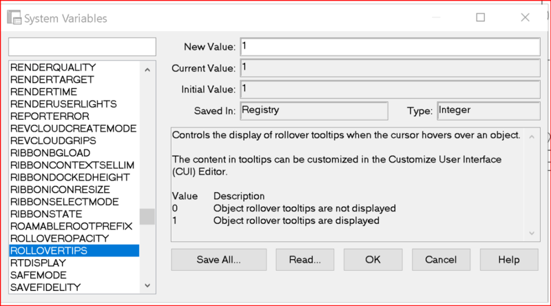

tombu Posted March 28, 2022 Posted March 28, 2022 On 3/18/2022 at 11:24 AM, Giovannino60 said: My problem is when I enter the mouse cross in a screen, the mouse cross gets stuck inside the screen, is there any way to fix this? Thank you Open the CUI and select Rollover Tooltips, then select Hatch on the right and unselect the box for General on the right. On the bottom-right click the [Apply] button then the [OK] button. Your cursor will no longer stick to Hatches! Many of my drawings are dense with contour lines represented as lwpolylines so I keep Polylines unselected as a Rollover Tooltip in mine. Customizing Rollover Tooltips https://help.autodesk.com/view/ACD/2022/ENU/?caas=caas/video/youtube/lesson/144642-courseId-100329.html 1 Quote

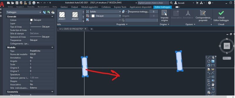

Giovannino60 Posted March 28, 2022 Author Posted March 28, 2022 I got here what should I deselect? Thank you Quote

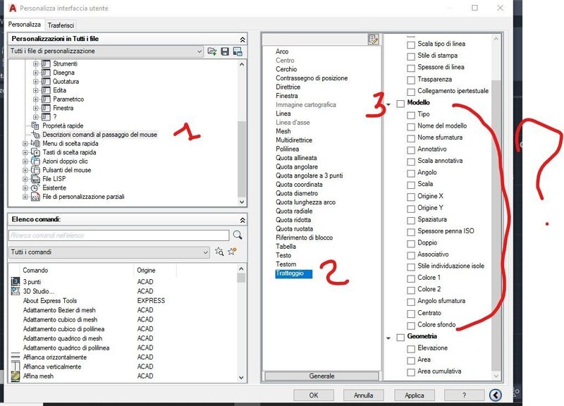

tombu Posted March 28, 2022 Posted March 28, 2022 13 minutes ago, Giovannino60 said: I got here what should I deselect? Thank you Did you watch the video? English is my only language, I couldn't read anything in the image you attached. You could deselect the box for General shown in the video but you really need to first pick Hatch from the list of object types and unselect the box for General on the right. Then the curser will no longer stop on hatches trying to display information about them. There is also a ROLLOVERTIPS (System Variable) you can set to 0 so you'll never see another one again! https://knowledge.autodesk.com/support/autocad/learn-explore/caas/CloudHelp/cloudhelp/2020/ENU/AutoCAD-Core/files/GUID-22E75D39-E601-41BD-935C-B359345DC47E-htm.html That's what mine is set to! 1 Quote
Giovannino60 Posted March 28, 2022 Author Posted March 28, 2022 I do not understand what I have to do. If you click on the last word, does it come out as I see it? Then what should I do? Quote
Giovannino60 Posted March 28, 2022 Author Posted March 28, 2022 Show me the autocad page image of when you write ... and unselect the box for General on the right? Thank you Quote
