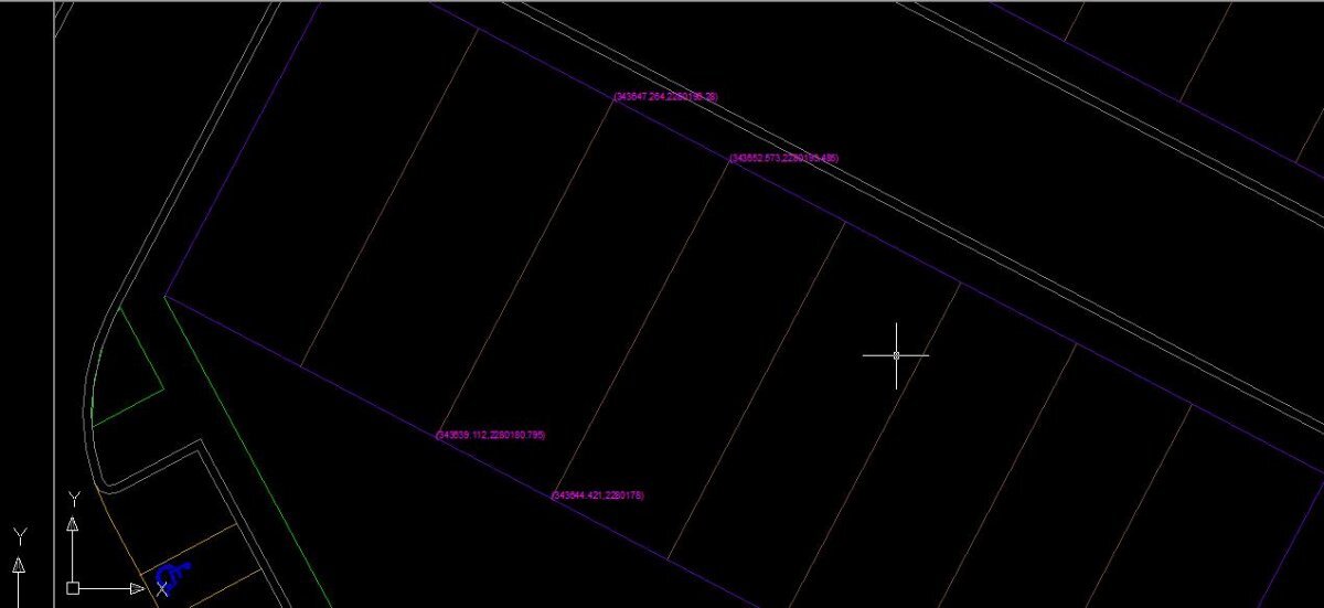

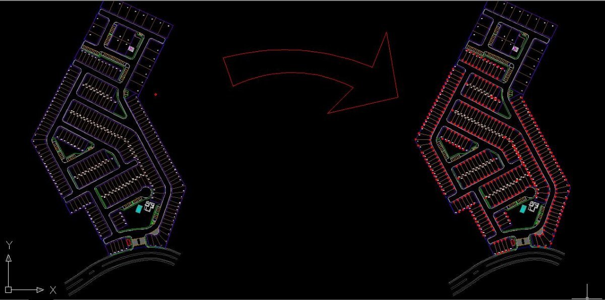

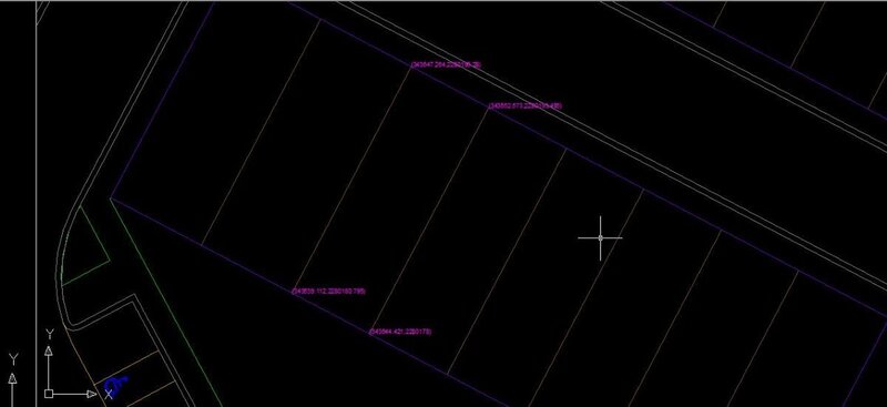

Isaac26a Posted February 12, 2022 Share Posted February 12, 2022 (edited) I want to know if any of you can help me to make this piece of code work faster, it does what is needed but takes some time to achieve the task, I use it to copy Surface Label Points (0 . "AECC_SURFACE_ELEVATION_LABEL") on Civil3D but it can also be circles, by the way I couldn't find an insertion point for this (surface label points) elements so I had to ask for an insertion point, anyway I'll get by just by making it faster. And also I wanted to select lines that are in a xref but didn't find out how, It would be also helpfull to know how to. Thanks in advance for taking your time and helping. ;;; Copy multiple objects on start and end points of lines on a selected layer ;;; 20220212 By Isaac A. (defun c:c2l ( / ent lst lyr pt pt1 ss ss1 ) (setvar "cmdecho" 0) (vl-cmdf "_.undo" "_begin") (setvar "osmode" 37) (princ "\nSelect the object(s) to copy. ") (setq ss1 (ssget)) (setq pt (getpoint "\nSelect a base point: ")) (setq ent (entsel "\nPick a line on the target layer: ")) (setq lyr (cdr (assoc 8 (entget (car ent))))) (if (setq ss (ssget "_X" (list '(0 . "LINE") (cons 8 lyr)))) (progn (foreach line (vl-remove-if 'listp (mapcar 'cadr (ssnamex ss))) (setq lst (cons (cdr (assoc 10 (entget line))) lst) lst (cons (cdr (assoc 11 (entget line))) lst) ) ) (foreach pt1 lst (vl-cmdf "_.copy" ss1 "" pt pt1) ) ) ) (vl-cmdf "_.undo" "_end") (princ) ) Also leave you an example file and the xref file. 20220204 base.dwg example.dwg Edited February 15, 2022 by Isaac26a Quote Link to comment Share on other sites More sharing options...
