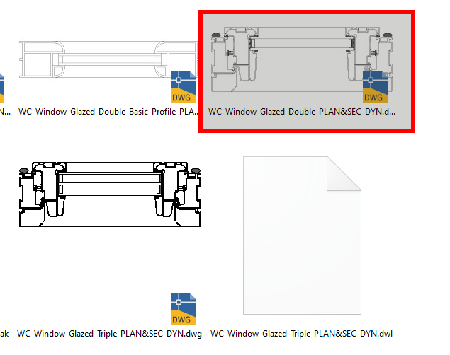

3dwannab Posted February 8, 2022 Posted February 8, 2022 (edited) I use this lisp in my start up so I have these system variables whenever. ;; Thumbnail settings (setvar "THUMBSAVE" 1) (setvar "THUMBSIZE2D" 1) ;; This is very important. The max resolution of the thumbnails is 256 if this is 0. (setvar "THUMBSIZE" 4) (setvar "UPDATETHUMBNAIL" 16) I recently upgraded to a 4k monitor but as you can see the thumbnail appearance differs from what I had before. Is there something else that could affect this. I like the highlighted one better which was on my old monitor. It just looks less jaggy. The bottom left is the one that's saved there with the new monitor. I've uploaded the block that's affected if that makes any difference. WC-Window-Glazed-Triple-PLAN&SEC-DYN.dwgFetching info... Edited February 9, 2022 by 3dwannab Quote

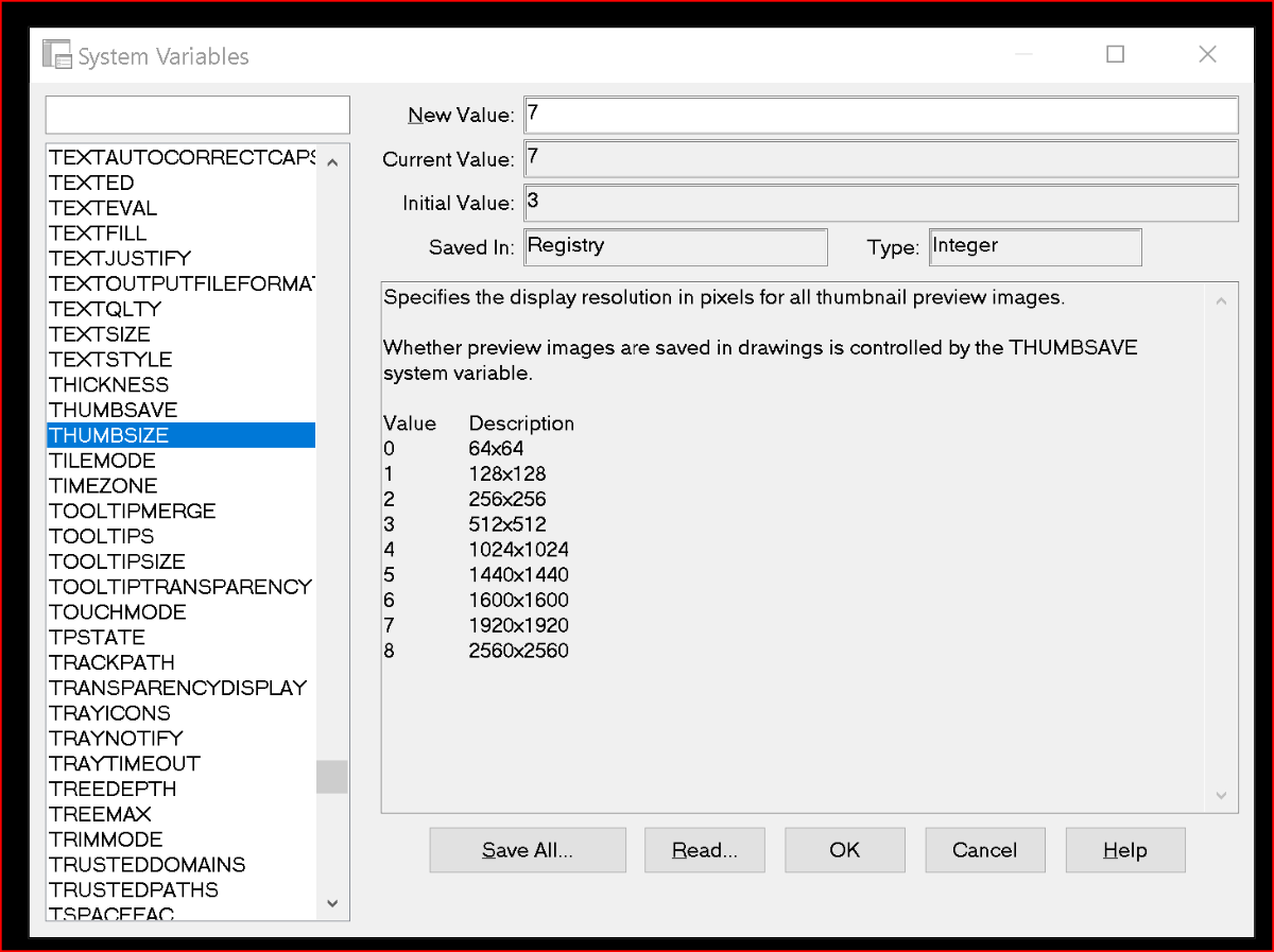

Dadgad Posted February 9, 2022 Posted February 9, 2022 Is the computer screen also 4K? Looking at the SYSVDLG I see theses options for thumbsize available. I suggest you try setting your thumbsize variable to 8, as per the screenshot. Quote
3dwannab Posted February 9, 2022 Author Posted February 9, 2022 I tried that there and no change. Quote

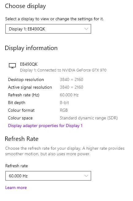

3dwannab Posted February 9, 2022 Author Posted February 9, 2022 Thanks Dana!! I'm using the display 2.0 port and it says it's outputing out at 3840 x 2160, custom scaling set to 100% and nothing else that I can see that is affecting this. So you're saying ACAD is not picking that up? Quote
Dana W Posted February 9, 2022 Posted February 9, 2022 (edited) Sorry, I just read your reply I guess DP 4 is newer than DP 1.4. I just went clueless again. Dana It does not support 4k through the DP port. This is because HDR support for DisplayPort was only introduced in DisplayPort 1.4. HDR: Nvidia graphics cards. Are you seeing this condition on a computer monitor or a TV monitor? TV monitor LEDs or LCDs are about 4 times bigger than a computer monitor pixel. I don't know about a 4k TV monitor LED size, but computer monitor screens Edited February 9, 2022 by Dana W 1 Quote
3dwannab Posted February 9, 2022 Author Posted February 9, 2022 Oh, I just checked the specs and it's 1.2 DP on my 48.5" Acer EB490QK https://www.displayspecifications.com/en/model/3be71376 I'll try to route a HDMI to it and an see. I always thought that a DP was better than HDMI. Quote
