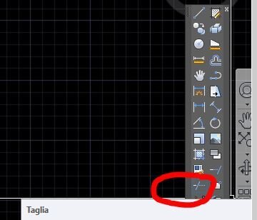

In autocad there are two icons for cutting, the one with the hatch I can't find it anymore as I look for this way of cutting. Did I just find the scissors?
Giovannino60

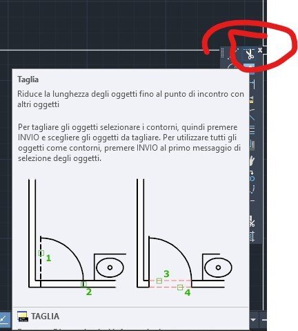

In autocad there are two icons for cutting, the one with the hatch I can't find it anymore as I look for this way of cutting. Did I just find the scissors? Thank you
The scissors would indicate you are using the TRIM command would it not?  Look under Tools for EXTRIM.
Edited by ReMark
Here is another option that may work but I do not have AutoCAD 2010 to actually test it on.  It is a lisp routine by Joe Burke called CookieCutter2_v1.0.  Use the APPLOAD command to load the routine.  To run the routine type either CookieCutter2 or CC at the command line.  It is supposed to work on hatch patterns.
