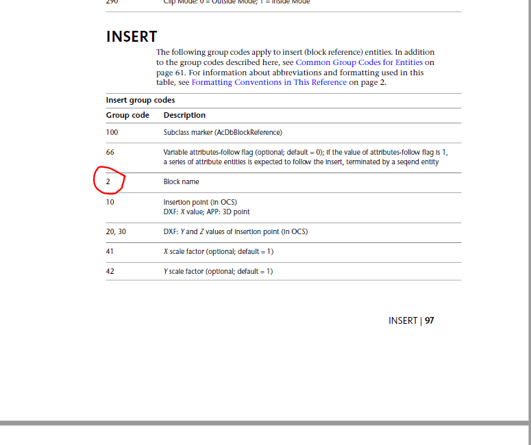

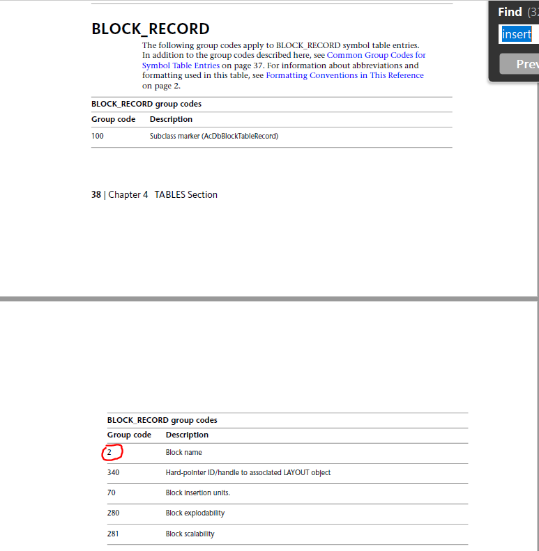

but there is one fundemental issue that i'm trying to figure out for some time:
this type of code - (setq blk (cdr (assoc 2 (entget e))))
"e" is set to a block entity,and that block entity do have a list of arguments,that is clear.
cdr means  "get the second item on that arguments list (or just any list..)".
in the dxf-reference_enu, both in the BLOCKS Section (Chapter 5 BLOCKS Section) and the insert section (Chapter 6 ENTITIES Section) the block name is indeed assoc code 2 (I've attached a screenshot from the dxf manual),so that is also clear to me why the use of assoc 2.
so why the use of cdr?
1. what is the logic Behind this, and why it is wrong to write "(setq blk (assoc 2 (entget e)))?
2. why do we need the entget when e is already set to a block object,which means that it an entity from the beginning?
thanks for patience...😀
Ari.
Edited by aridzv

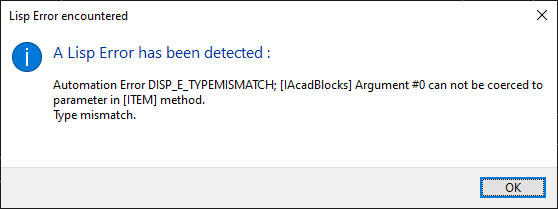

e is a temporary variable inside the foreach function. all e is before the entget is the entity name  <Entity name: 3d99d260> think of it as a book number in the Dewey Decimal System in a library. the libray is the drawing the book is the entity. you don't know whats in the book unless you go get it that's what entget does.
It takes the entity name and looks in the drawings your working with returning
((-1 . <Entity name: 3d99d260>) (0 . "INSERT") (5 . "1E7") (330 . <Entity name: 3d998de0>) (100 . "AcDbEntity") (67 . 0) (410 . "Model") (8 . "0") (370 . -1) (100 . "AcDbBlockReference") (66 . 1) (2 . "PVC TEE SW-THREADED 63x2In") (10 374.0 116.0 0.0) (41 . 1.0) (42 . 1.0) (43 . 1.0) (50 . 0.0) (70 . 0) (71 . 0) (44 . 0.0) (45 . 0.0) (210 0.0 0.0 1.0))
Asso 2 is saying tell me whats list that starts in 2 is and returns the following.
cdr says return everything but the first item.
If you used it on 10 the insertion point it would return a list with three items
(374.0 116.0 0.0)
To answer your questions #1 ill refer to the above entget
(setq blk (assoc 2 (entget e))) = (2 . "PVC TEE SW-THREADED 63x2In")
  This will error when using it in def becaues its only looking for a name in quotes
(setq def (vla-item (vla-get-blocks (vla-get-activedocument (vlax-get-acad-object))) blk))
  This would work but why wait just use cdr when your setting the variable
(setq def (vla-item (vla-get-blocks (vla-get-activedocument (vlax-get-acad-object))) (cdr blk)))

last question about this issue ("...just use cdr.."):
why using cdr and not get the full list?
why ommiting the first item on the list,the entity name (<Entity name: 3d99d260> in this case)?
is it possible to use (setq blk (assoc 2 (entget e)))?
thanks,
Ari.
Edited by aridzv
Answered above. right above the screen shot.
