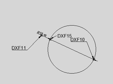

And mtext the DXF 10 11 and 15
But for a given AcDbDiametricDimension. How I can get?  , or the circle obj or the circle handle or circle entity name or whatever a way to handle the diametral dim text position

Off course that the entget for the same dim have its code 10 11 and 15
(setq ent (car (entsel)))
(setq ent-dat (entget ent))
(setq dxf10 (cdr(assoc 10 ent-dat)))
(setq dxf11 (cdr(assoc 11 ent-dat)))
(setq dxf15 (cdr(assoc 15 ent-dat)))
DXF11 for the text insertion point
DXF15 for the near point at circle
DXF10 for the far point at circle
Of course with  a  (ssget "f"  10 15 , i can get the CIRCLE ent .

diametral circle with DXF.dwg
Owner id is reset every time you load a drawing.
I posted some code but cant find it. it was either entsel or entget that used the point to select another entity.
you could use that to with dxf cod 10 or 15 to select the circle to get what you need.
