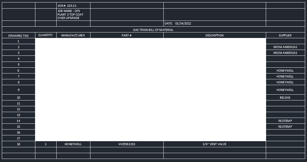

Why does a Data Table link to excel hide data.
I made a excel spread sheet and linked it to an AutoCAD Light Table.
This is what I get:
Why is my data being blinked out and how do I fix this?

I use the Autocad tables command in AutoCAD 2014 Lt to create a table.
I select insert options from a data link  to my select my Excel file and make my
cell range.

I still have not figured out why a white appears in my AutoCAD table when it is linked to an excel file.
I don't know if it is coming form the excel file or it is in the AutoCAD table.

I think formatting border lines in excel might be creating this problem.
I went back and exported my date to Notepad then put it on sheet 2.
 I created a link in AutoCAD. This time I did not format the excel borders.
The linked AutoCAD table was good.
That may be the problem.
Thank you,

I cut/paste and replaced data in the excel sheet from MS word.
The reason I did that I was to make text in all CAP's
I think that process created my blank out problem.
The work around was to place data into notepad
before putting it bank into excel.
I think that that fixed the problem.
