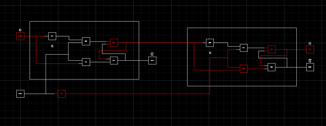

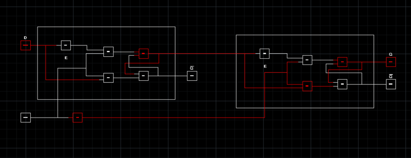

; Logic Diagram Simulator - 2022.01.24 exceed
; caution - if this lisp loaded. block "and, or, nor, nand, not, lamp, switch" will be added
; please try this in empty drawing.
; command "and" - make and gate
; command "or" - make or gate
; command "not" - make not gate
; command "nand" - make nand gate
; command "nor" - make nor gate
; command "switch" - make switch (input)
; command "lamp" - make lamp (output)
; connecting these blocks with Polyline (LWPOLYLINE)
; then simulate with command "sw"

I know this is not suitable for use in autocad. this is just for fun😄
switch on off command is "SW"
The order of the polyline's start and end points should go from left to right.
Use the block names "switch" "and" "or" "not" "nor" "nand".
Find the input and output terminals as offsets from the basepoints of the gates and determine on/off by color
I want to add oscillator but seems difficult.
maybe it seems to be possible to make something like (command "regen") run 10 times
Once the "clock" is created, there will be many more things that can be done.
