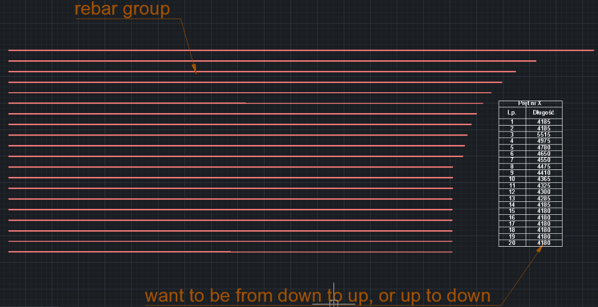

HI,
I've moddified lisp found here
To make table of rebar lenghts ( TABELAZPRETOW.lsp lisp in attachment).

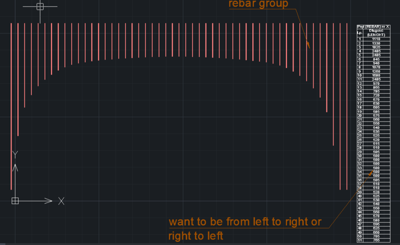

The lisp is creating table, but the thing is, that it is giving values propably base on it creation (newest first). So for expamle if i delete rebar in the middle and create new one, it is going on start of the table. Want it to create table form lef/right (right/left) oraz from up/down (down/up).
Thought that it could be done by just asking user how to sort, like multiradiobuttons and search by X or Y values of points. But maybe there is some way to recreate objects or something like that, what would rearrange objects form left/right, down/up?
It will be easier way, becouse sometimes I must make table few times and If it will ask user all the time to choose up/down, left/right it would be annoying/
Attached sample dwg and images

The easiest is to sort say on length.
(setq s (ssget '((0 . "LWPOLYLINE") (-4 . "=") (8 . "BZ_P_roz")))) ok now make a list of the rebar properties say by length then sort on length. Ps dont need -4 as  layer correct filter. ((120)(2400)(1586).....
Same again but make list with (X Y length) so could do sort on X for vertical bars and sort Y for Horizontal bars need choice. ((x y len) (123.45 56.7 1234)..... or sort on length.

Not that great at making tables so used @confutatis code from this post.
Will ask to select polylines then what side you want to start from. sort according to answer and then ask for point to create table. seemed small so i had to scale it up by 10. isn't quite like your table so maybe confutais can come in and fix that part.
Updated code pulled from lisp attached. also added numbering of lines to double check for correct lengths.

I left the code alone.
All I did was take the user selection (ssget) outside of the function.
I made an extra function that does the ssget selection, then sorts it according to a few options (which can be easily expanded).
You can sort from left to right for the vertical polylines (command rbrtab_x) , or from bottom to top for the horizontal ones (command rbrtab_y).
Or sort by length which is what you want, I guess.  (command rbrtab).

WoW!!!!
thanks @mhupp and @Emmanuel Delay; both lisp works well !!!!
@Emmanuel Delay, actually I've want rtab_x and rtab_y :) It is better for " on site" to be up/down left/right
@mhupp You did great Job. It is also numbering rebars. I will try to add to ask user to get firstly number of rebar; like for expample "4" and then it will number it like 4.1, 4.2, 4.3 etc. Also need to add round of the lenght.
Guys! You did work for me! actually I thougt I will do this myself just with Your help, but the job is done!!!
Thank You so much!
