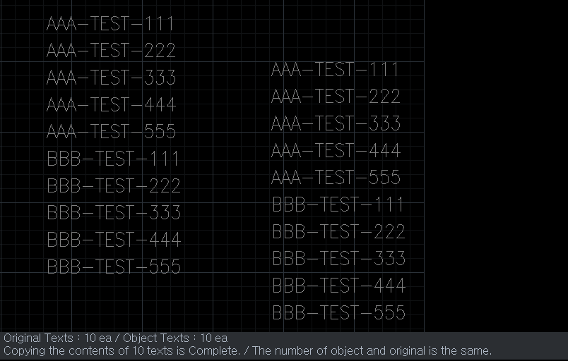

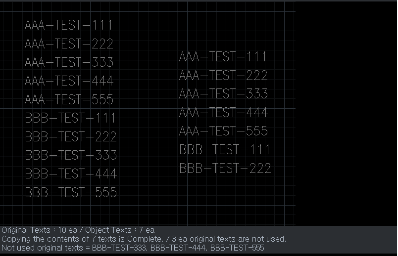

this is for practice vl-sort function.
Copies contents from multiple texts to multiple texts in vertical 1 column
Someone must have made it, but I couldn't find it so made it.
This is useful for editing old-style tables (consisting of text and lines).
in example, when the text pasted from outside of AutoCAD, but it has a different form ... etc.

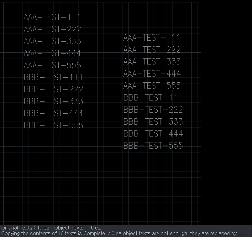

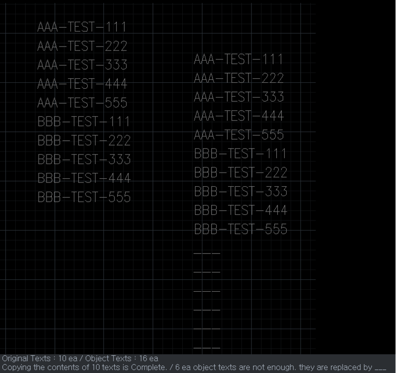

typo : object texts are not enough -> object texts are left. not enough original texts.
I fixed in code, but I can't take screenshots again😅
Since it was built using y-value comparison, it's easy to create for x-values as well.
However, the reason why this lisp uses the y value
is the same as the reason why vlookup is used more than hlookup in excel. 😄
Edited by exceed
SUPPORT MTEXT, UNDO SETTING
