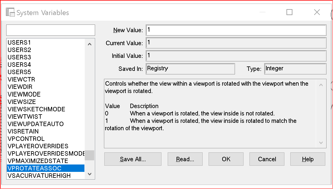

dannysteel Posted January 12, 2022 Posted January 12, 2022 I'm making a view port in paper space everything looks good until I double click inside the view port and my geometry or drawing rotates automatically,. I thing it's a command that you know you change to 1 instead of 0 or vise versa so that my geometry won't rotate or rotate it in view port but with out rotating it in model space. thanks, Quote
Dadgad Posted January 12, 2022 Posted January 12, 2022 (edited) System variable, as shown in the screenshot...When you double click inside the viewport, that takes you into Modelspace, which is why the view rotates. If you just want to adjust the view displayed in your viewport, instead of rotation, UNLOCK your viewport, don't click THROUGH it. Activate it by just selecting it. Set the view and scale how you want it to display, then RELOCK your viewport with Properties. Edited January 12, 2022 by Dadgad spelling Quote
