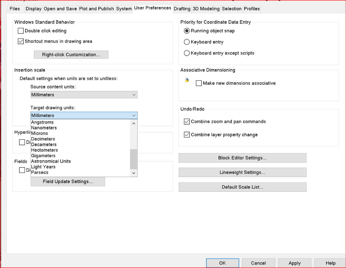

Take a careful look at this screenshot from Options, and you too may see the light...
Might you notice a few drawing units which give you cause to pause?  :huh:
