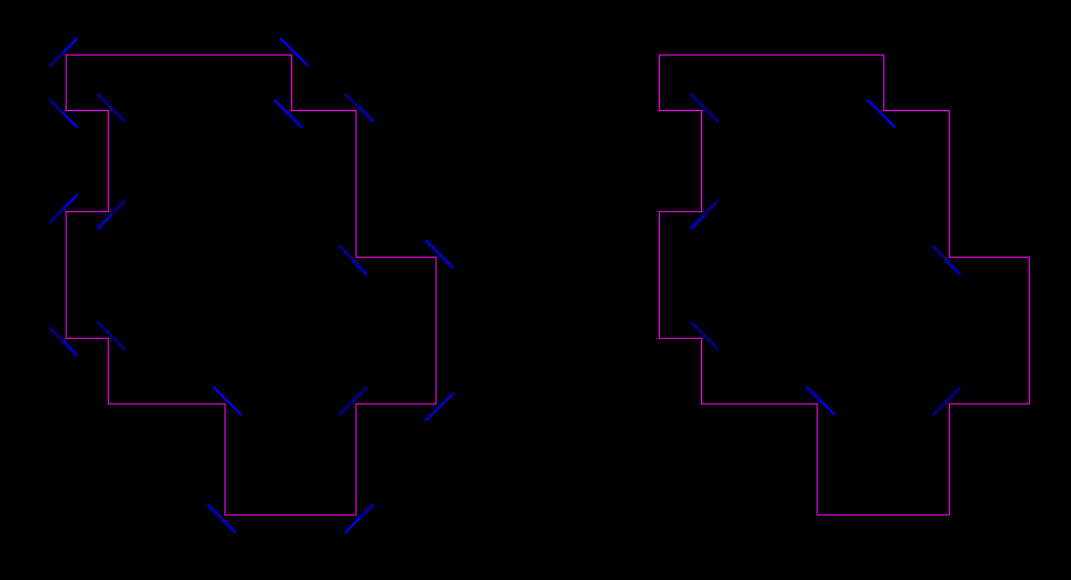

Corner Bars for Foundations
Yirmeyahu
I need help inserting the rebar block on all 90 degree corners greater than 2'-0" and have them inserted to the inside of the polygon.  Here is what I have so far.  Right now the command inserts the block on all 90 degree corners, both inside and outside of the polygon.

Try this, you should not check for 90 as this is for concrete slabs a architect may have a slab with a angle. Also the bar angle should be a true 90 from the internal corner angle. See images.

how about to approach like this
make selection set of re-bars
then use SWP.lsp, it will make selection of inside of closed polyline (not visually closed, pedit > C required)
then substract(except) selection set
https://forums.autodesk.com/t5/visual-lisp-autolisp-and-general/manipulating-splitting-a-selection-set/m-p/9649124/highlight/true#M402727
then delete.

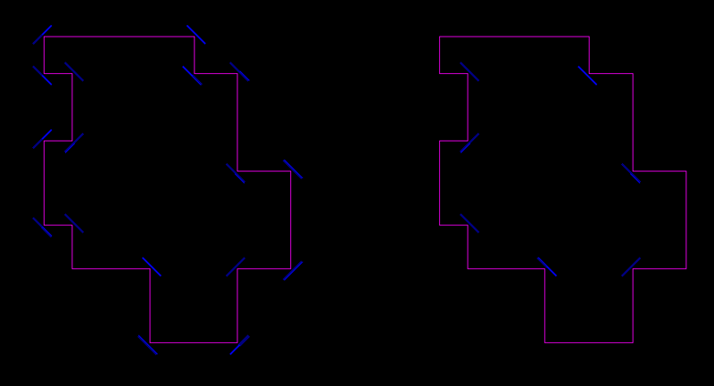

Perfect... but it only needs the bars at locations greater the 2'-0".  Anything less than 2'-0" does not need these bars.
Thanks Bigal
Edited by Yirmeyahu
Have if statement to check dist pt1 to pt2 and pt2 to pt3 to be greater then 2'.

Crossover from. https://www.cadtutor.net/forum/topic/74248-multiple-assoc-values/
Modified the lisp a little so it doesn't need to create layers/objects to generate the points.
-Edit note-
rebar block will be inserted at 0 z height if selecting 2d poly even if that poly is at a different elevation.
