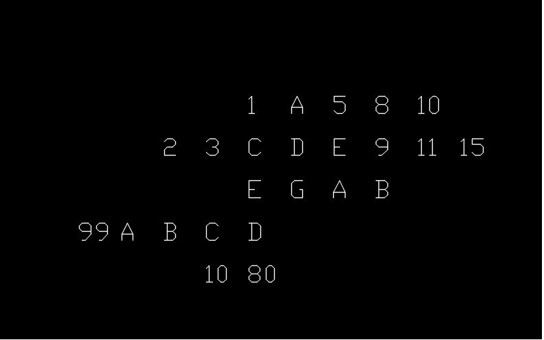

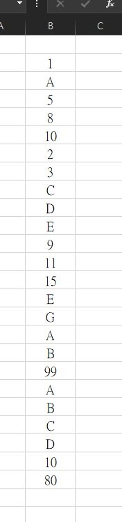

Dear All,
Is there any way to let Text export to csv/txt sort by coordinate , i hope it can sort  From left to the right, from top to the bottom

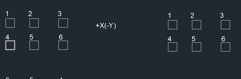

This routine can export text and x, y, z coordinates to excel
I get this at
https://forums.autodesk.com/t5/visual-lisp-autolisp-and-general/autocad-how-get-text-to-excel-use-visual-lisp/td-p/9539871
then I add LM:unformat for mtexts.
http://www.lee-mac.com/unformatstring.html
then add first row for filter,
then sort ascending C column (y axis, up to down) first, B column (x axis, left to right) second in excel.
https://support.microsoft.com/en-us/office/sort-data-in-a-table-77b781bf-5074-41b0-897a-dc37d4515f27
