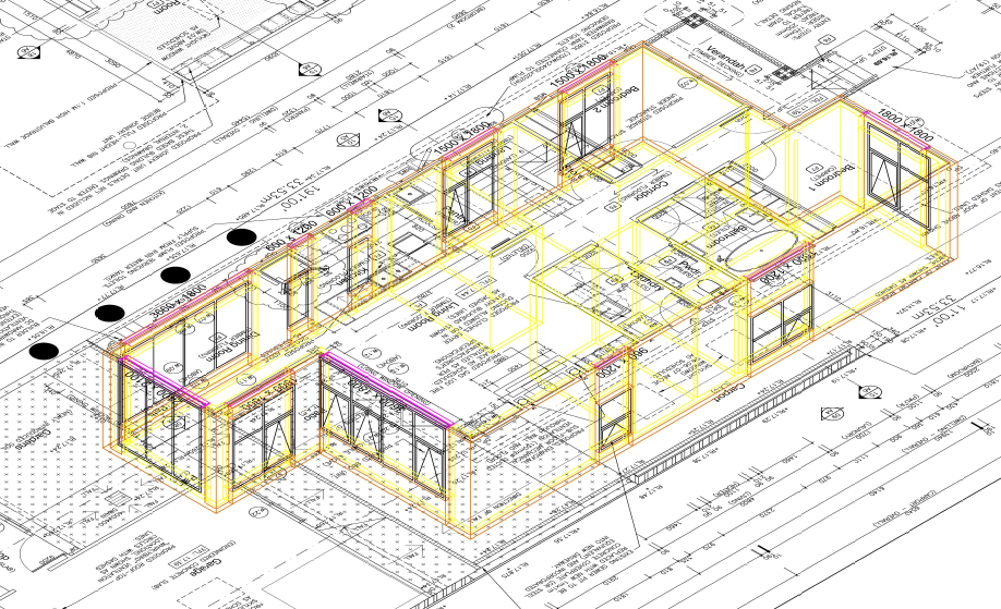

aliscan Posted December 25, 2021 Posted December 25, 2021 Hi When I want to dimension for the wall quantity, I want it to number each dimension. Is something like this possible? But it needs automatic numbering when dimensioning. Also, if you have any add-ons to share for the wall footage, I would like to receive them. And it would be much nicer if I could export them to excel. Thank you for your help Quote

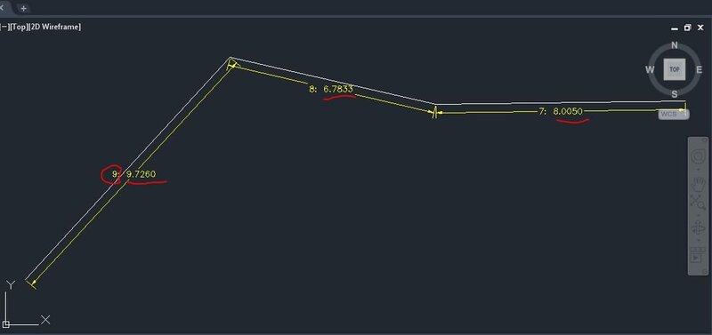

hosneyalaa Posted December 26, 2021 Posted December 26, 2021 hi test this is ;;;https://forums.autodesk.com/t5/visual-lisp-autolisp-and-general/lisp-to-dimension-only-width-and-length-of-a-polyline/m-p/10799893/highlight/true#M424578 (vl-load-com) (defun DP (side / *error* clay cmde styht plsel pl cw inc pt1 pt2 pt3 pt4) (defun *error* (errmsg) (if (not (wcmatch errmsg "Function cancelled,quit / exit abort,console break")) (princ (strcat "\nError: " errmsg)) ); if (setvar 'clayer clay) (setvar 'osmode osm) (command-s "_.undo" "_end") (setvar 'cmdecho cmde) (princ) ); defun -- *error* (setq clay (getvar 'clayer) osm (getvar 'osmode) cmde (getvar 'cmdecho)) (setvar 'cmdecho 0) (setvar 'osmode 0) (if (not *DPseq) (setq *DPseq 1)) (command "_.undo" "_begin" "_.layer" "_make" "A-ANNO-DIMS" "_color" 2 "" "" ;; <---EDIT if desired ); command (setq styht (cdr (assoc 40 (tblsearch "style" (getvar 'dimtxsty))))); height of text style in current dimension style (if (= styht 0.0) (setq styht (* (getvar 'dimtxt) (getvar 'dimscale)))); if above is non-fixed-height (setq s (ssget '((0 . "*POLYLINE")))) ;;; (while ;;; (not ;;; (and ;;; (setq plsel (entsel "\nSelect Polyline: ")) ;;; (wcmatch (cdr (assoc 0 (entget (car plsel)))) "*POLYLINE") ;;; (= (logand (cdr (assoc 70 (entget (car plsel)))) 88) 0) ;;; ;; not 3D or mesh [88 = 8 (3D) + 16 (polygon mesh) + 64 (polyface mesh)] ;;; ); and ;;; ); not ;;; (prompt "\nNothing selected, or not a LW or 2D Polyline.") ;;; ); while (while (setq plsel (ssname s 0)) (setq pl (vlax-ename->vla-object plsel)) (vla-offset pl styht); temporary (setq cw (< (vla-get-area (vlax-ename->vla-object (entlast))) (vla-get-area pl))) ;; clockwise for closed or clearly inside/outside open; may not give ;; desired result for open without obvious inside/outside (entdel (entlast)) (repeat (setq inc (fix (vlax-curve-getEndParam pl))) (setq pt1 (vlax-curve-getPointAtParam pl inc) pt2 (vlax-curve-getPointAtParam pl (- inc 0.5)); segment midpoint pt3 (vlax-curve-getPointAtParam pl (1- inc)) ); setq (if (equal (angle pt1 pt2) (angle pt2 pt3) 1e-8); line segment (command ; then "_.dimaligned" pt1 pt3 "_text" (strcat (itoa *DPseq) ": <>") ); [leaves at dimension line location prompt] (command ; else [arc segment] "_.dimangular" "" (inters ; arc center (setq pt4 (mapcar '/ (mapcar '+ pt1 pt2) '(2 2 2))) (polar pt4 (+ (angle pt1 pt2) (/ pi 2)) 1) (setq pt4 (mapcar '/ (mapcar '+ pt2 pt3) '(2 2 2))) (polar pt4 (+ (angle pt2 pt3) (/ pi 2)) 1) nil ); inters pt1 pt3 "_text" (strcat (itoa *DPseq) ": " (rtos (abs (- (vlax-curve-getDistAtParam pl inc) (vlax-curve-getDistAtParam pl (1- inc)))) 2 0) "mm" ;; [edit mode and precision and suffix as desired -- this is per request on AutoCAD Forum] ); strcat ); command [leaves at dimension line location prompt] ); if (command ; complete Dimension: dimension line location (polar pt2 (apply (if (or (and cw (= side "in")) (and (not cw) (= side "out"))) '- '+) (list (angle '(0 0 0) (vlax-curve-getFirstDeriv pl (- inc 0.5))) (/ pi 2) ); list ); apply (* styht 1.5) ;; [If you don't use stacked fractions, consider using styht without multiplier] ); polar ); command (setq inc (1- inc) *DPseq (1+ *DPseq) ); setq ); repeat (ssdel plsel s) ) (setvar 'clayer clay) (setvar 'osmode osm) (command "_.undo" "_end") (setvar 'cmdecho cmde) (princ) ); defun -- C:DP (defun C:DPI () (DP "in")); = Dimension Polyline Inside (defun C:DPO () (DP "out")); = Dimension Polyline Outside (prompt "\nType DPI to Dimension a Polyline on the Inside, DPO to do so on the Outside.") 1 Quote
Steven P Posted December 26, 2021 Posted December 26, 2021 That's quite a complicated way of doing what BigAl did in 5 lines..... My usual way of going is fewer simpler LISPs to remember but have them more versatile for many cases. So in this case using BigAl which will dimension lines and polylines and using the drawing set up for dimension style would be the way I would go as opposed to having a LISP just to dimension polylines with a defined dimension style, and by inference another LISP for lines, and another for gaps, and another if I want to use a different dimension style (different clients for example) Quote

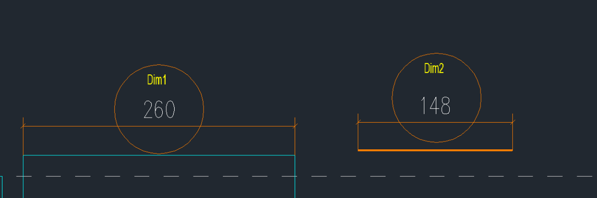

aliscan Posted December 27, 2021 Author Posted December 27, 2021 Hi hosneyalaa I want it to be dimensioned by marking, not this way. So when I mark the beginning and the end, it will be numbered sequentially. When I exit the command and want to continue again, the numbering will continue where I left off. thanks Quote
Tharwat Posted December 27, 2021 Posted December 27, 2021 Give this program a try and let me know. (defun c:Test (/ *error* 1pt 2pt old new hgt ins pos) ;; Tharwat - 27.Dec.2021 ;; (defun *error* (msg) (princ) ) (or *dim:nos* (setq *dim:nos* 1)) (and (setq *dim:nos* (cond ((getint (strcat "\nSpecify increment number [ " (itoa *dim:nos*) " ] : " ) ) ) (*dim:nos*) ) ) (setq 1pt (getpoint "\nSpecify first point dimension : ")) (while (setq 2pt (getpoint "\nSpecify next point : " 1pt)) (setq old (entlast)) (command "_.DIMALIGNED" "_none" 1pt "_none" 2pt "\\") (and (not (= old (setq new (entlast)))) (setq blk (tblobjname "BLOCK" (cdr (assoc 2 (entget new))))) (or (while (not (= (cdr (assoc 0 (setq get (entget (setq blk (entnext blk))))) ) "MTEXT" ) ) ) get ) (setq ins (cdr (assoc 10 get))) (setq hgt (cdr (assoc 40 get))) (entmake (list '(0 . "TEXT") (cons 10 (setq pos (polar ins (angle (polar 1pt (angle 1pt 2pt) (/ (distance 1pt 2pt) 2.0) ) ins ) (* hgt 1.5) ) ) ) (cons 11 pos) (cons 1 (strcat "Dim " (itoa *dim:nos*))) (assoc 40 get) (assoc 50 get) (assoc 7 get) '(71 . 0) '(72 . 1) '(73 . 2) ) ) (setq 1pt 2pt *dim:nos* (1+ *dim:nos*) ) ) ) ) (princ) ) Quote
aliscan Posted December 28, 2021 Author Posted December 28, 2021 Mr. Tharwat Thank you Can we export these dimensions to excel in order? Dim1 260 Dim2 148 .... As Quote
