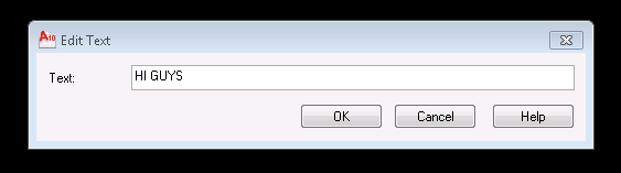

mousho Posted December 23, 2021 Author Share Posted December 23, 2021 what im looking is when u double click on text a dialog box will open and over there i will change the text now i am using mtext that open notepad++ and change the encoding over there to ansi its not so comfortable attached examplpe of dialog box in my work Quote Link to comment Share on other sites More sharing options...

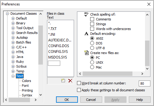

dan20047 Posted December 23, 2021 Share Posted December 23, 2021 I'm not understanding your question. Are you already changing the variable MTEXTED to launch notepad++ ? https://knowledge.autodesk.com/support/autocad/learn-explore/caas/CloudHelp/cloudhelp/2016/ENU/AutoCAD-Core/files/GUID-9083A065-0CED-4BBC-A998-E031E7A57726-htm.html If the issue is notepad++ is always changing to ANSI encoding, I would assume there is a setting to another default such as UTF-8. I use textpad and it has that option. Quote Link to comment Share on other sites More sharing options...
