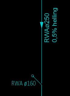

B.N. Posted December 22, 2021 Share Posted December 22, 2021 (edited) Hello, I have some drawings containing 2D lines in multiple layers (by pipe diameter). Now I manually check each intersection or vertex and mark the right fittings needed. Is it possible to create a simple object (a circle or something) at each vertex/intersection in a layer named as for example "dia 315 Y" "dia 160 elbow".... it's only for informational purpose, the looks don't matter. I need to order the right pieces and that takes a hell of a lot of time.... example.dwg Edited December 22, 2021 by B.N. photo added Quote Link to comment Share on other sites More sharing options...
mhupp Posted December 22, 2021 Share Posted December 22, 2021 (edited) This would be a good idea but looking at the drawing it would need updating for this to work properly. the RWA lines switch between lines and polylines some times they don't even connect like just below your example. also some of your lines are at different elevations so their isn't an intersection even tho they look like their is. (use flatten command) for this to be an automated process it would either not know where intersections are or give you to many false positives. it would be better to make a lisp helping you in manually selecting intersections. and then asking what kind of fitting to use. Edited December 22, 2021 by mhupp Quote Link to comment Share on other sites More sharing options...

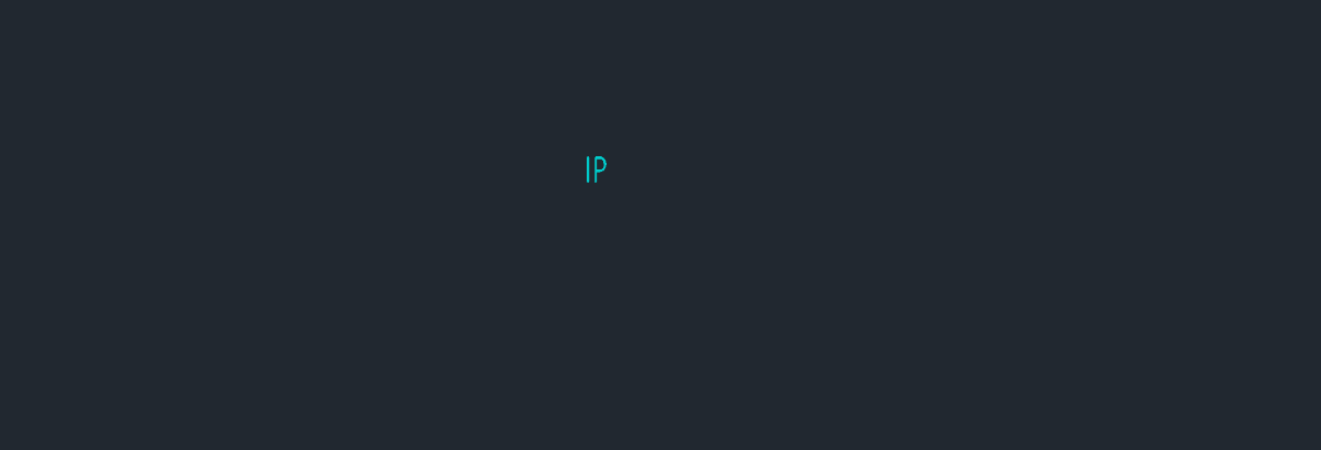

BIGAL Posted December 22, 2021 Share Posted December 22, 2021 (edited) This is another problem that can be solved better. The lines do not meet properly. You can use a wipeout under the IP text so all the lines still meet but appear broken. Just me I think you need to start from ground up draw lines correct layer, do chamfer the 4 options easy choice, add pline lable. Add ends ie circle etc. Plus more, I would look at improving the whole process starting from a blank drawing. Have a think about that. Edited December 22, 2021 by BIGAL Quote Link to comment Share on other sites More sharing options...

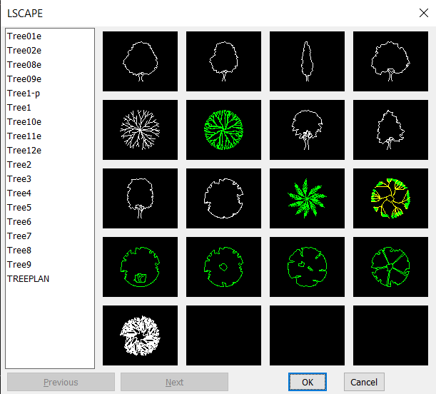

B.N. Posted March 30, 2022 Author Share Posted March 30, 2022 On 1/20/2022 at 11:38 PM, BIGAL said: 1st up AT:listselect was written by Alan J Thompson. That acknowledgement should be in code. replace the defun (defun C:BlkInsert (/ pt SS ent lst blkname) (vl-load-com) (setq lst (list "blkname1" "blkname2" "blkname3" "blkname4")) (while (setq pt (getpoint "\nPick Point")) (setq blkname (AT:ListSelect "Block(s) in Drawing" "Pick A Block" 30 60 "false" lst)) (vl-cmdf "_.Insert" (car blkname) "_non" pt 0.0254 0.0254 0) ) (princ) ) Also can use dcl's and images The images would be interesting! How can this be added? What DCL's would you suggest? The code works as a charm! thanks @mhupp Quote Link to comment Share on other sites More sharing options...
