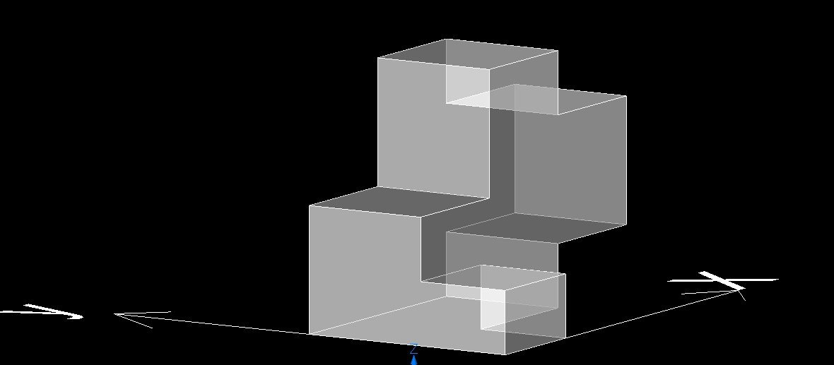

Hello, Is it possible to calculate the thickness of a solid at any point (x-y plane)
I tried this solution, I also tried creating a cuboid and creating a common part.
Both solutions are very slow. I have to do several hundred thousand checks
Maybe the solution would be to xplode the solid and check the distance between two regions (surfaces and angled regions are a potential problem). Anyone has an idea how this could be done ?

If you explode the solid.  This will give you the width and depth from top view of what ever you have selected. These are 3d points so it doesn't matter what view you select entity's in.

Great solution, has one drawback. If the region is at an angle it will not give the height at the selected point. However, thank you very much for your help this version already solves 90% of cases.

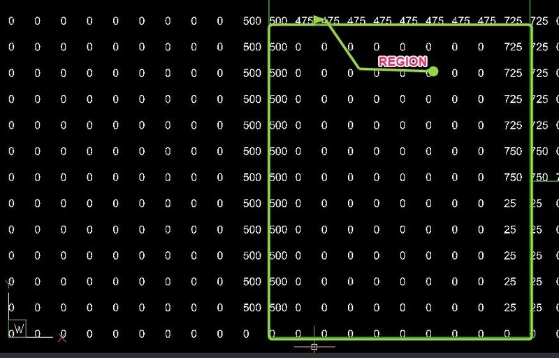

Hi, I have encountered another problem. How to select regions within a window. I have assumed that I will check the height in 100mm increments. Everything works ok on the edges but I cannot select the correct regions if I am inside. I have used:
(setq SS(ssget "_B" (list PX PY -1000) (list (+ VX PX) (+ PY VY) 10000) '((0 . "REGION"))))
unfortunately this solution does not work.
You are misunderstanding what command bbd is doing. I have combined my two answers. You don't need to explode the solids anymore.
this will ask to pick a solid and a point.
create a section of the solid on the xy plain from the point picked.
the cross section will then have the z height x and y dims displayed
That is the thickness at 2.490 height in the x and y direction
