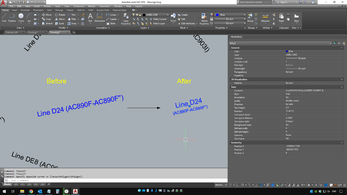

Hello,
I have mtext objects containing Line names and Pegs between brackets. I need to add a line break before the open bracket "(" and make the second line smaller by x0.6.
I don't know how to write Lisp, so I tried adding the mtext formatting codes using Find/Replace, but the codes are showing as text and not changing the appearance of the text.
Any help appriciated. Thanks
Like this

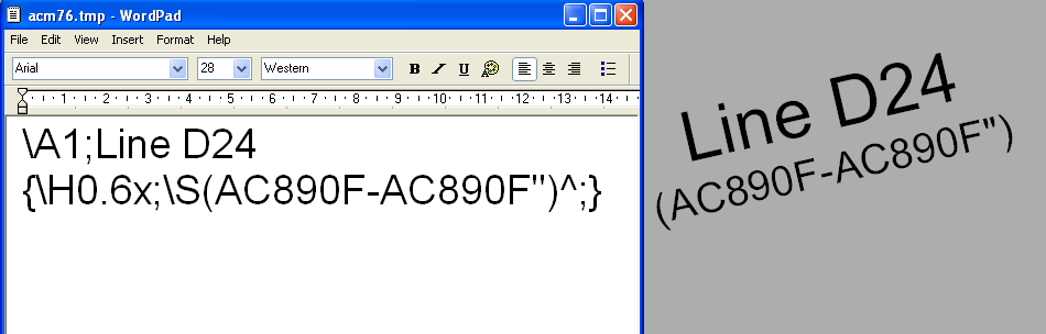

If you change the default Mtext editor to something like NotePad or WordPad, you can put in the formatting codes.
I would say that your example drawing showed what you could do already without any help.
However, the bottom line seemed to be a bit closer, so I stacked the bottom line.

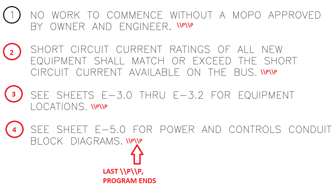

I have a query sort of related to this.  My desire is to "see" a \\P\\P and start an action from that...like copy a block to the next line of text.  The action needs to be automated for each \\P\\P until the end of the mtext block.  Is this possible?
Thanks for any help or ideas.
It's odd how things happen in succession, how are you for modifying LISPs? See the last code in the link below from a couple of days ago, it takes out the \\P using LM:Str->LST code and then remakes the string using LM:lst->str code.
If you change the delimitators from \\P to \\P\\P (P and p to capture either way) in str->lst and then in the lst->str use a delimitator \\P\\P and add in whatever block of text you want that should do.
