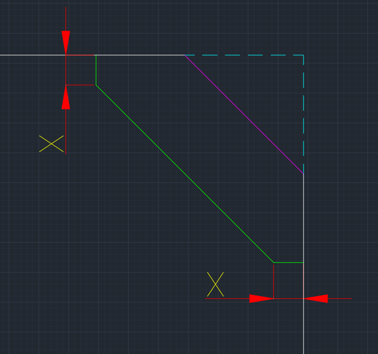

Nick24 Posted December 14, 2021 Posted December 14, 2021 Hi guys! Can you please help with a small issue? I'm in need of a chamfer that makes the below shape (green line). Do you know if AutoCAD can do this or is there any free routine for this? Basically, except the chamfer distances there should be an additional question for the user to insert the "X" values. Thanks! Quote

Nick24 Posted December 15, 2021 Author Posted December 15, 2021 (edited) Thanks for replying@BIGAL! The rest of the line beyond the green one is not necessary. Just like a normal chamfer, it should be erased. All that’s required is that green line shape. Additionaly, small green lines are to be always perpendicular on the original lines and this should be applicable only to lines/polylines, not arcs/splines/etc; and small green lines have always same length, so the user needs to be asked for 2 things: distance of the small green lines from the nearest endpoint and the “X” value, meaning the length. And in the end, a line should be drawn to join those 2 small green lines. Hope i was clear enough. @mhuppsorry for asking, but why is this unpolite? When you’re in need, every help is useful Edited December 15, 2021 by Nick24 Quote

BIGAL Posted December 16, 2021 Posted December 16, 2021 Ok distance from IP point to green line, so not a chamfer answer rather, just draw a 90 line of X length from both sides then join all done. Don't have anything and need to do real work 1st, just draw circle and get the 2 intersection points. Which brings us to another question are they lines or a pline please state. Note answer should allow for non 90 corners. Quote
Nick24 Posted December 16, 2021 Author Posted December 16, 2021 @BIGAL, the principle of doing that shape can be like a chamfer or something else, it doesn’t matter. Only the result matters The shape should be pline and it should allow non-90° angles for the original lines. Quote

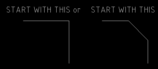

BIGAL Posted December 17, 2021 Posted December 17, 2021 I am not being difficult but avoiding doing code like 3 times. Quote
Nick24 Posted December 17, 2021 Author Posted December 17, 2021 @BIGAL, start with second option Quote
