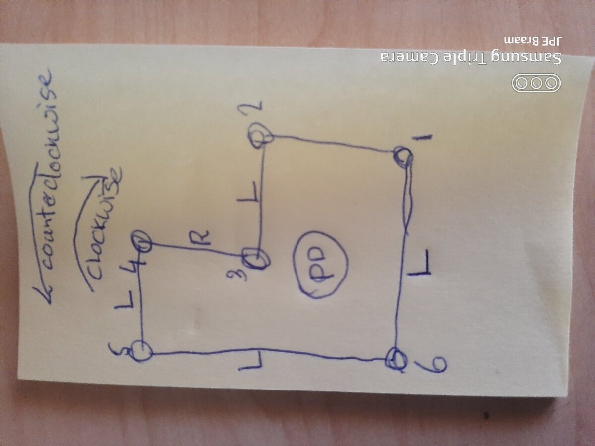

Designer68 Posted December 13, 2021 Share Posted December 13, 2021 Hello Is there a way (lisp) to label lines. I want to draw multiple lines (buildings) and i need a label in the center of each line with the text Left or Right. Based on the location of the previous line. if possible starting clockwise and counter clockwise as well. Quote Link to comment Share on other sites More sharing options...

mhupp Posted December 13, 2021 Share Posted December 13, 2021 Its best to upload a sample drawing of what your looking to do. Quote Link to comment Share on other sites More sharing options...
Designer68 Posted December 13, 2021 Author Share Posted December 13, 2021 This is the example. Start point and toen above ech line if i went left or right. The most drawings i have to make are counterclockwise. Quote Link to comment Share on other sites More sharing options...
mhupp Posted December 13, 2021 Share Posted December 13, 2021 Made this for someone a couple of months ago. They would import a satellite photo and they wanted to pick the corners of the house. ;;----------------------------------------------------------------------------;; ;; L Shape House (defun C:LHouse (/ p1 p2 p3 p4 p5 p6) (setq p1 (getpoint "\nPick Point 1") p2 (getpoint "\nPick Point 2") p3 (getpoint "\nPick Point 3") p4 (getpoint "\nPick Point 4") p5 (getpoint "\nPick Point 5") ) (setq p6 (list (car p5) (cadr p1))) (setvar 'cmdecho 0) (command "_.pline" "_non" p1 "_non" p2 "_non" p3 "_non" p4 "_non" p5 "_non" p6 "_CL") (setvar 'cmdecho 1) (princ) ) Don't know about the L or R's 1 1 Quote Link to comment Share on other sites More sharing options...
BIGAL Posted December 13, 2021 Share Posted December 13, 2021 If you draw a pline of picked points and close as normal, then get vertices/co-ordinates you can determine using say pt1 pt2 pt3 angle, is it L or R then label etc the last leg is like angle pt6 pt1 pt2 you should label leg 1-2 need time to think. 2 Quote Link to comment Share on other sites More sharing options...

Designer68 Posted December 14, 2021 Author Share Posted December 14, 2021 9 hours ago, BIGAL said: If you draw a pline of picked points and close as normal, then get vertices/co-ordinates you can determine using say pt1 pt2 pt3 angle, is it L or R then label etc the last leg is like angle pt6 pt1 pt2 you should label leg 1-2 need time to think. Bigal, Pt 1 Pt2 needs no label, because it is from the startpoint. So the label starts between 2 and 3 Quote Link to comment Share on other sites More sharing options...

BIGAL Posted December 14, 2021 Share Posted December 14, 2021 There is better examples of this as many points as you want Close is supported but still need a enter to stop, busy today so sorry no code time. (defun c:plpts ( / pt) (setq pt (getpoint "\nStarting point of Pline : ")) (command-s "_.pline" pt) (while (getpoint "\nPick next pt Enter to stop") ) ) 1 Quote Link to comment Share on other sites More sharing options...
