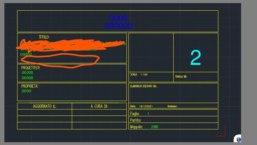

In this block, how should I proceed to add a row
In this block, how should I proceed to add a line, see the image with the red ellipse?
Thank you
Disegno1.dwg

If you only want to add another piece of data, you could use ATTDEF to define a new attribute.
I just want to add a line to write more words ...
Look up "multiline attribute." Or use the DDATTDEF command to create a multiline attribute. Or change the multiline property of an existing attribute.
