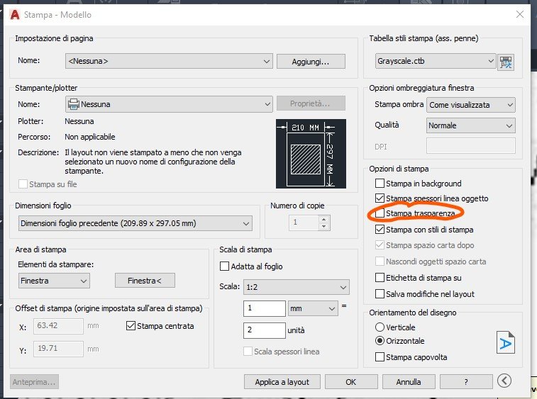

How should I proceed to save the transparent print setting
How should I proceed to save the transparent print setting, when I scratch this setting and then go out and re-enter it I have to put it back?

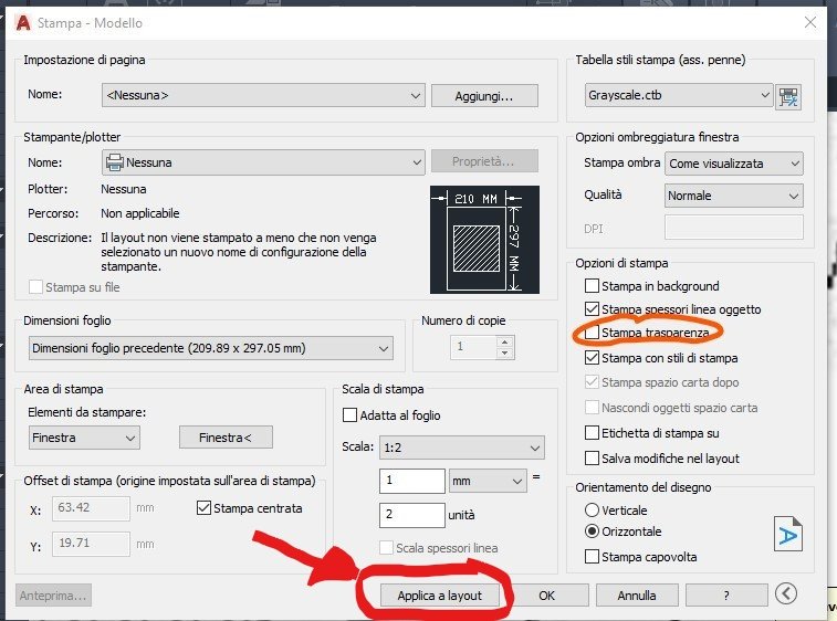

I think u Just pick Apply to Layout in 1st print, then it will remain as you wish
