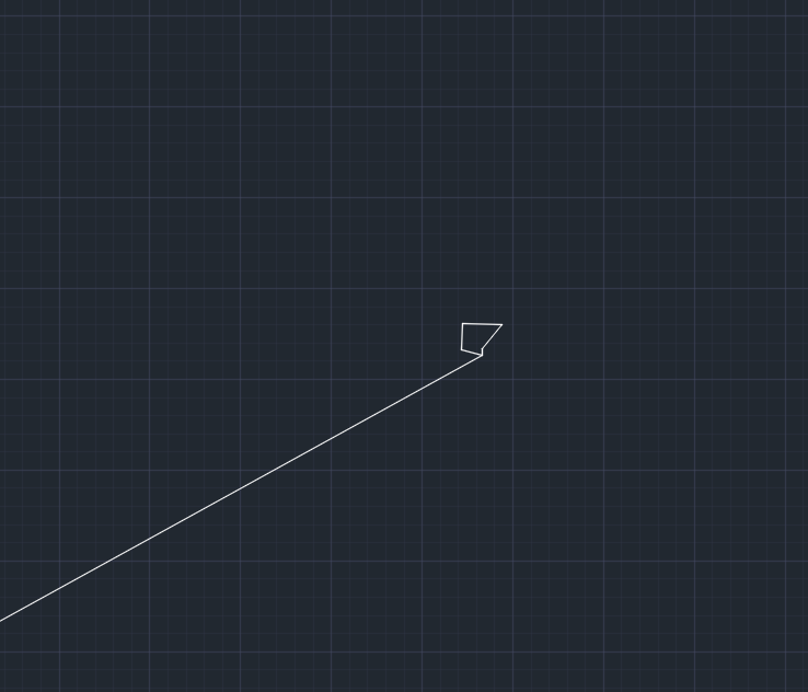

HI! I too am struggling with entering the survey data in- I have created the benchmark and once I begin putting in the POBs they are super tiny and I can never Close them....I changed the ltscale to 50
I'm not familiar with the Oleson project, but civil is my field.
A benchmark is a reference point. It doesn't necessarily lie inside the area of interest. The POB is the single point from which you transit the other boundary lines. It looks like you've drawn a line from the benchmark to the POB and then continued around the boundary. The boundary doesn't end at the benchmark, it should end at the POB.
If this doesn't help, please provide more information. What is the goal of the exercise? What information do they give you? How is LTSCALE relevant to the project?
Thank you for your help.. I guess I thought entering in the POBs would make a larger boundary maybe? Like I have it set up wrong? This is the project I'm working on below :)
