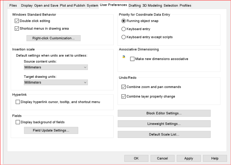

In OPTIONS check Priority for Coordinate Data Entry on the User Preferences Tab.  Presumably it will already be set as shown in the screenshot.  That sets your OSNAPCOORD system variable setting to = 0.
I've always left OSNAPCOORD (System Variable) set to the Initial value of 2 as coordinate values are important for Civil 3D. There may be other uses for AutoCAD correct coordinates aren't that important but I couldn't recommend modifying a default system variable without explaining why.
