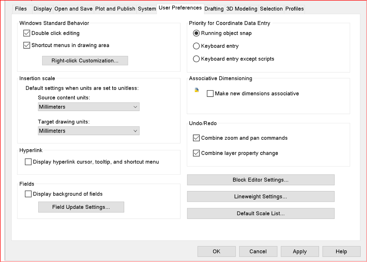

In OPTIONS check Priority for Coordinate Data Entry on the User Preferences Tab.  Presumably it will already be set as shown in the screenshot.  That sets your OSNAPCOORD system variable setting to = 0.
OK thanks.
I have set Priority for Coordinate Data Entry to Keyboard entry though as that's a preference.
It's the snap with the mouse though. And it's a visual thing, when you hover a point, you're not as sure if it's snapped. Or as described before, like a magnetic aspect.
