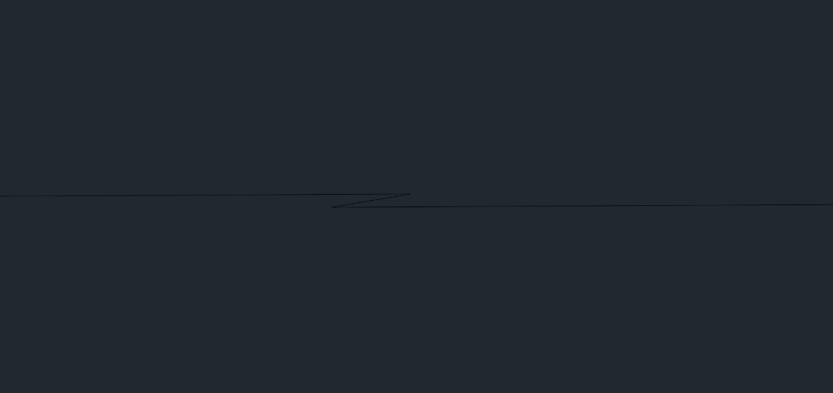

Hello,
I need a LISP which allows me to connect the closest endpoint of polylines in order to close shape.
_pedit->join with fuzz distance doesn't work. I also can't join them via additional line.
sample picture
distance between lines is 0.0001mm
Thanks in advance

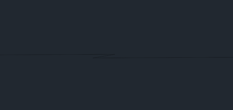

Thanks for tip, however MPEDIT is not a good solution in my case. This function join both endlines by additional line - see picture in attachement.
Becouse I use these drawings in CNC laser, that kind of "shapes" where i have 0.00001mm line, affects very bad on machine works. Machine tries to change direction on distance 0.0001mm and servo motor starts go crazy.
I need solution, which allows me to connect both endpoint to one smooth line.
