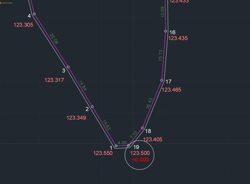

Hi . I have a landsurvey problem.I want insert a new elevetion text for my measure points without change the origial elevetion.
I want to set the +0.000  on point 19 with original elevetion 123.500  and minus  123.500  from all others  selected elevetions and insert  the new elenetion for example +0.10 or -0.25 etc
Thanks

See if you're happy with this.
Command CNE
Then select block with id 19, which will be the +0.000 base.
The value is set in attribute DESC (is this okay?).
You just have to drag that attribute to a good position.

Nice job  Emmanuel Delay. Thanks  😀😀
But if i want to change specific points and not all points how to do it?
Edited by prodromosm
Then you remove the "_X".  Then you get to select the blocks.

Hi Emmanuel Delay i want to ask for some changes
1) The start 0.00 i want ot have 2 decimals not 0.0
2) All the calculations to have  2 decimals not 3
Thansk
You can use RTOS for the fixed number of decimals.

Hi Emmanuel Delay .I want to ask you samething similar with the previous post.
in the previous example the elevetion tag in the attribiute have  numbers with 3 decimals. Is any way to change the previous code not to calculate new elevetion this time to replace all the elevetion tags with  the same elevetion but with 2 decimals .  for example the point 3 have 123.317 --> 123.32
Thanks
Sure.
Do you mean this?
I added Rounding functions (from Lee Mac); I RTOS just cuts off the digit, but you want it rounded up/down.
This code requires the functions I put in the previous comments

The code works fine .The only error calculation i find is in number 11 with elen 122.945 gives me 122.94 . I beleve that the correct is 122.95. All the other numbers ifor example 16  have elev 123.435 --> 123.44 if the third desc is 5 round up .
