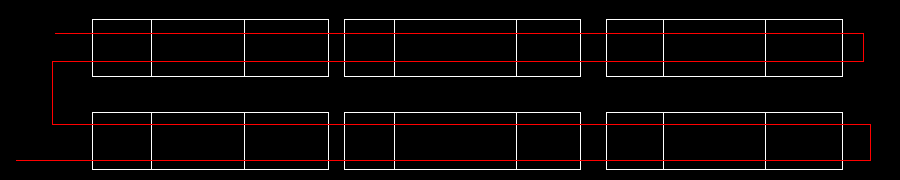

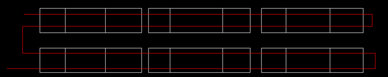

Silver2022 Posted November 27, 2021 Share Posted November 27, 2021 Hi all. I need create points and get numbering at the intersection positions of line, polyline; and vertex polyline. Can you help me create lisp? If you can help me export the number information to excel (include number, x coordinate, y coordinate), that would be great. test.dwg Quote Link to comment Share on other sites More sharing options...

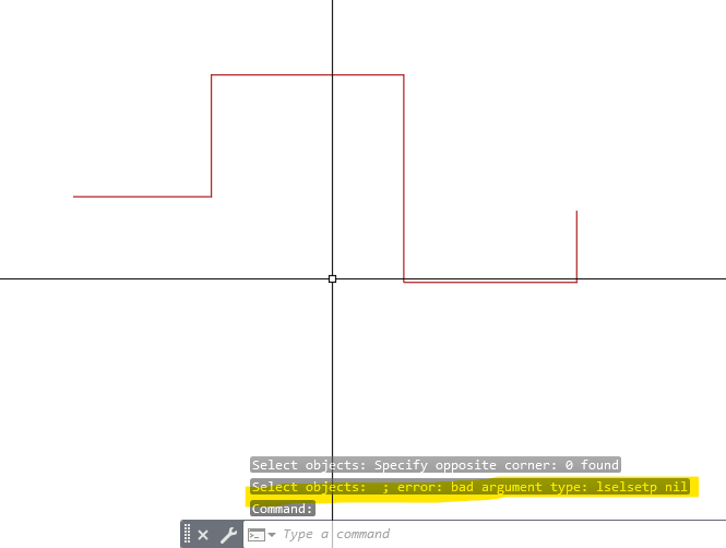

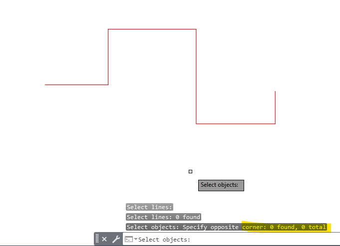

vitor Posted February 1 Share Posted February 1 Hi, @hosneyalaa! Could you help me with your code? I'm trying to run it on AutoCAD 2024, but it seems to not be working as it should be. It won't let me select the polyline in the first prompt and doesn't recognize it: Thanks in advance!! On 11/30/2021 at 5:00 AM, hosneyalaa said: try ; q_|_|| _\|| q_|| _\| ;;;(SETQ objPline objSelection) (defun GetVerticies (objPline / intParam lstVerticies) (repeat (1+ (setq intParam (fix (vlax-curve-getendparam objPline)))) (setq lstVerticies (cons (vlax-curve-getpointatparam objPline (float intParam)) lstVerticies)) (setq intParam (1- intParam)) ) lstVerticies ) ;;; Tharwat 15. Feb. 2013 ;;; (defun _Mid (p1 p2) (mapcar '(lambda (j k) (/ (+ j k) 2.)) p1 p2) ) ;;;(SETQ lstVerticies lstReturnXY) (defun GetSegments (lstVerticies) (mapcar '(lambda (X Y) (- (if (eq Y (last lstVerticies)) (vlax-curve-getdistatparam objSelection (vlax-curve-getendparam objSelection)) (vlax-curve-getdistatpoint objSelection Y)) (vlax-curve-getdistatpoint objSelection X))) (reverse (cdr (reverse lstVerticies))) (cdr lstVerticies) ) ) (defun GetAngles (lstVerticies) (mapcar '(lambda (X Y) (* 180 (/ (angle X Y) pi))) (reverse (cdr (reverse lstVerticies))) (cdr lstVerticies) ) ) (defun AREA1(e) (vlax-curve-getarea e )) (defun LM:lst->str ( lst del / str ) (setq str (car lst)) (foreach itm (cdr lst) (setq str (strcat str del itm))) str ) ;;;;;;;;;;;;;;;;;;;;;;;;;;;;;;;;;;;;;;;;;;;;;;;;;;;;;;;;;;;;;;;;; ;; by GP_ https://forums.autodesk.com/t5/autocad-portugues/identificar-texto-dentro-de-um-poligono-polyline-fechada/td-p/7138674 ;; http://www.cadtutor.net/forum/showthread.php?84483-Check-if-a-point-is-inside-an-area-bounded-by-a-polyline&p=578928&viewfull=1#post578928 (defun inside_p (list_vert :p / out_p cross on) (setq out_p (list (car (getvar "extmax")) (* 1.1 (cadr (getvar "extmax"))))) (setq cross 0) (mapcar '(lambda (a b) (if (or (equal (angle a :p) (angle :p b) 1e-8) (equal a :p 1e-8) ) (setq on t) ) (if (setq :p: (inters :p out_p a b)) (setq cross (1+ cross)) ) ) list_vert (cdr list_vert) ) (cond (on "ON") ((> (rem cross 2) 0) "INSIDE") (t "OUTSIDE") ) ) (defun vk_IsPointInside (Point PointsList / PY P1Y P2Y) ; works with polygons only, i.e. if (equal (car PointsList) (last PointsList)) (if (cdr PointsList) (/= (and (or (and (<= (setq PY (cadr Point) P2Y (cadadr PointsList) P1Y (cadar PointsList) ) PY ) (< PY P2Y) ) (and (> P1Y PY) (>= PY P2Y)) ) (> (car Point) (+ (* (/ (- PY P1Y) (- P2Y P1Y)) (- (caadr PointsList) (caar PointsList)) ) (caar PointsList) ) ) ) (vk_IsPointInside Point (cdr PointsList)) ) ) ) ;;;;;;;;;;;;;;;;;;;;;;;;;;;;;;;;;;;;;;;;;;;;;;;;;;;;;;;;;;;;;;;;;;;;;;;;;;;;;;;;;;;;;;;;;;;;;;;;;;;;;;;;;;;;;;; ;;;;;;;; http://www.theswamp.org/index.php?topic=18725 (defun vl-pline-centroid (pl / AcDoc Space obj reg cen) (vl-load-com) (setq AcDoc (vla-get-ActiveDocument (vlax-get-acad-object)) Space (if (= (getvar "CVPORT") 1) (vla-get-PaperSpace AcDoc) (vla-get-ModelSpace AcDoc) ) ) (or (= (type pl) 'VLA-OBJECT) (setq obj (vlax-ename->vla-object pl)) ) (setq reg (vlax-invoke Space 'addRegion (list obj)) cen (vlax-get (car reg) 'Centroid) ) (vla-delete (car reg)) (trans cen 1 (vlax-get obj 'Normal)) ) ;;;;;;;;;;;;;;;;;;;;;;;;;;;;;;;;;;;;;;;;;;;;;;;;;;;;;;;;;;;;;;;;;;;;;;;;;;;;;;;;;;;;;;;;;;;;;;;;; ;;;;;;;;;;;;;;;;;;;;;;;;;;;;;;;;;;;;;;;;;;;;;;;;;;;;;;;;;;;;;;;;;;;;;;;;;;;;;;;;;;;;;;;;;;;;;;;;;;;;;;;;;;;;;;;; (defun C:TEST (/ EEE FUZZ IIP IIPT INTP LSSPO LST NT NUMBLIST OBJPP PSELECTIONS PTLST SSTEXT STRN X) (vl-load-com) (princ "\nSelect lines: ") (princ "\nSelect lines: ") (setq sstext(ssget '((0 . "line")))) ;(ssget "X" '((0 . "text"))) (setq ptLst(mapcar '(lambda(x)(list (_Mid(cdr(assoc 10 x))(cdr(assoc 11 x))) (cdr(assoc 10 x)) (cdr(assoc 11 x)) )) (mapcar 'entget(vl-remove-if 'listp(mapcar 'cadr(ssnamex sstext)))))) (princ "\nSelect POLYLINE: ") (princ "\nSelect POLYLINE: ") (if (setq pSelections (ssget (list '(0 . "LWPOLYLINE,POLYLINE") '(70 . 1)))) ;(ssget "_X" (list '(0 . "LWPOLYLINE,POLYLINE") '(70 . 1))) (progn (setq IiPt 0) (setq intp -1) (setq nt nil) (repeat (sslength pSelections) (setq intp (1+ intp)) (setq objpp (vlax-ename->vla-object (setq eee(ssname pSelections intp)))) (setq lst (getverticies objpp));coord (245.237,149.595 0.0) (setq nt (append (cdr lst) nt)) (if (not (equal (car lst) (last lst))) (setq lst (cons (last lst) lst)) ) (setq IiP 0) (if ptLst (progn (REPEAT (LENGTH ptLst) (if (AND (= T (vk_IsPointInside (car(nth IiP ptLst)) lst)) (/= (inside_p lst (car(nth IiP ptLst))) "OUTSIDE") ) (progn (setq numblist (cons (car(cdr(nth IiP ptLst)))numblist)) (setq numblist (cons (cadr(cdr(nth IiP ptLst)))numblist)) ;(setq numblist nil) );; (progn );; (if (setq IiP(+ 1 IiP)) );;;REPEAT )) (setq nt (append numblist nt)) (setq numblist nil) ) (setq fuzz 0.001) ;; comparison precision (defun compare-points (a b) (if (equal (cadr a) (cadr b) fuzz) (< (car a) (car b)) (> (cadr a) (cadr b)) ) ) (setq nt(vl-sort nt 'compare-points)) (setq IiP -1) (REPEAT (LENGTH nt) (setq IiP (+ 1 IiP)) (if (nth IiP nt) (progn (setq IiPt(+ 1 IiPt)) (setq Lsspo (entmakex (list (cons 0 "TEXT") (cons 10 (nth IiP nt)) (cons 11 (nth IiP nt)) (cons 8 "T1") (cons 40 0.6) (cons 62 1) (cons 72 0) (cons 73 4) (cons 50 0) (cons 1 (RTOS IiPt 2 0 )) ) ) ) );; (progn );; (if ) (setq nt nil) ) ;;; repeat ) ) ; q_|_|| _\|| q_|| _\| ; q_|_|| _\|| q_|| _\| ; q_|_|| _\|| q_|| _\| ; q_|_|| _\|| q_|| _\| ; q_|_|| _\|| q_|| _\| ; q_|_|| _\|| q_|| _\| ; q_|_|| _\|| q_|| _\| ; q_|_|| _\|| q_|| _\| Quote Link to comment Share on other sites More sharing options...
