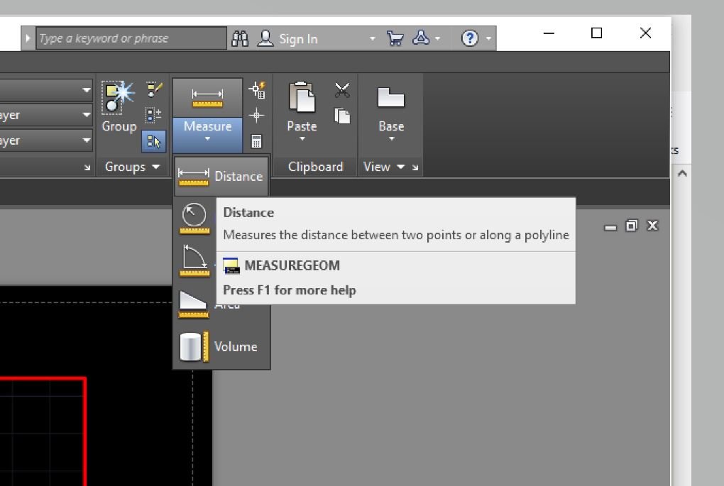

Is it possible to pin the menu option found  under Home / Utilities/ Measure / Distance, to measure distance on the screen?
This is the same item found under the _MeasureGeom /Distance command

Why not just add Measure Distance to your Quick Access Toolbar where it would always be on the screen for you to use?
Just hit the down-arrow at the right end of the QAT and select More Commands…
Scroll down and select Measure Distance.

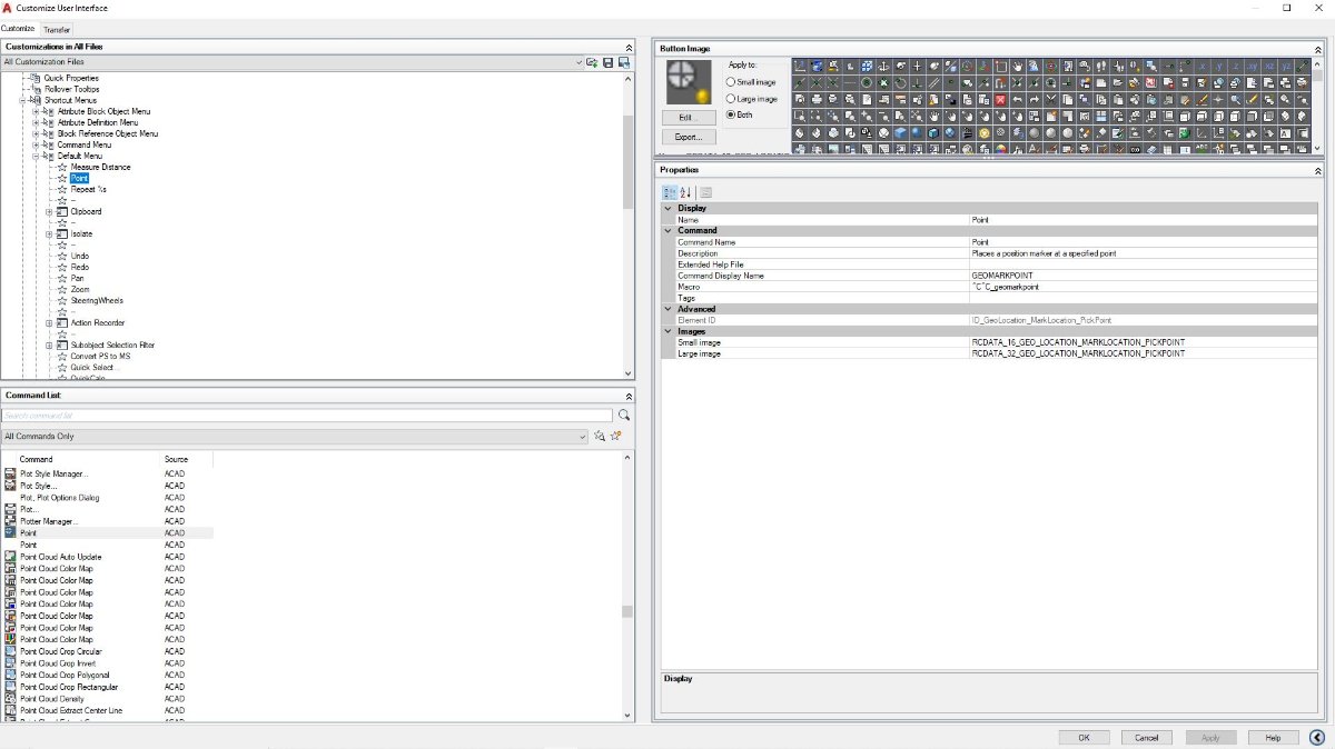

If you want to do that open the CUI → Shortcut Menus → Context menu for default mode
In lower-left search for "Distance" in "ACAD Commands" then drag "Measure Distance" up and place it into the "Context menu for default mode" menu.
Context menu for default mode is the default Right-Click menu when nothing is selected and no commands are active.
I'm guessing that's when you'll be using Measure Distance.
The best thing about Right-Click menus is that when you have an Mtext object selected the Right-Click menu will just be for modifying that Mtext, when you have multiple polyline objects selected the Right-Click menu will just be for modifying multiple polylines. Since the Right-Click menus offer command options for your current selection set adding specific commands for modifying a specific object or objects gives you quick access to the commands you normally use to modify those object or objects without having to look for them in the ribbon or toolbars.
You should decide which location you prefer though. Lots of handy things you can put in both places but keeping anything in both places would clutter both the QAT and the Context menu for default mode. Less commands in both places make selecting them quicker.

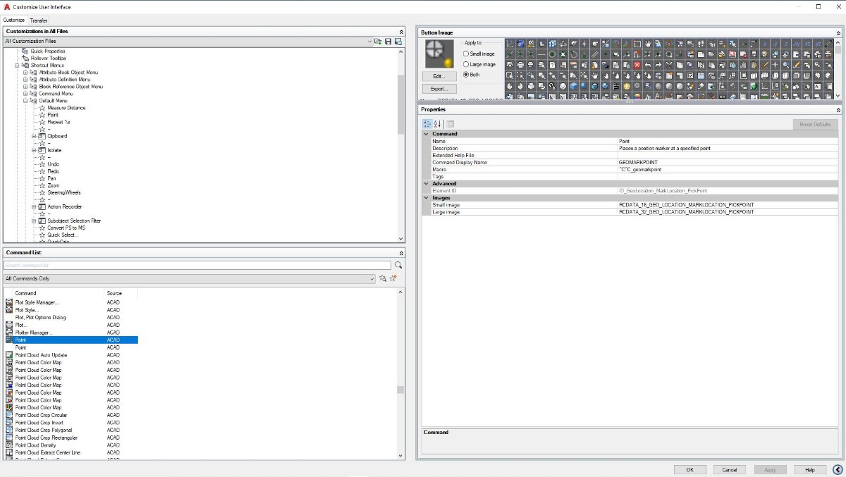

thanks for this SLW210 and tombu, it is a real eye opener. I  would like to put three commands on the right click default menu.
I  had never heard of CUI before, so this is a steep learning curve :)
I  was able to fit the "Measure distance " command in the right click default menu, and that now works beautifully.

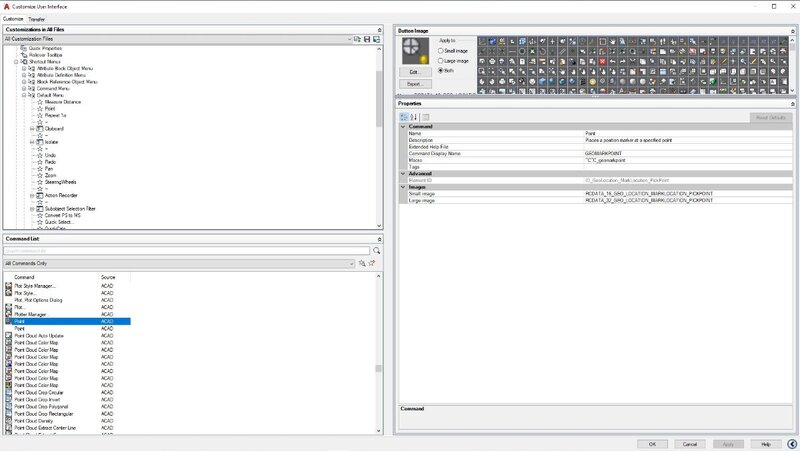

I  put the Point command in too, but that would not work. When I  select that item on the menu, I get the message in the Command box :
_geomarkpoint: No geographic location defined

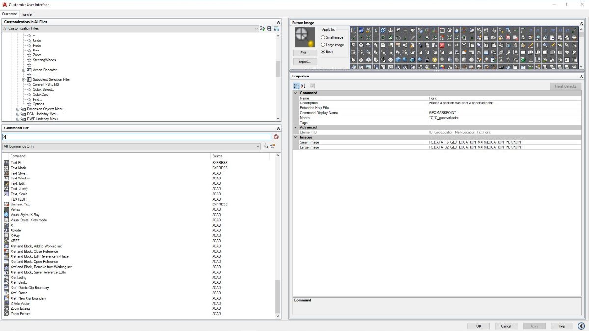

The other command I  use a lot is XLINE, but I  could not find  it in the list of Commands in the CUI
Can anyone please help with putting the POINT and the XLINE commands on the default right click menu?

First open Your Roamable Support Folder by entering
(startapp "explorer" (strcat "/n,/e," (getvar "roamablerootprefix")"Support"))
at the Command line then making a copy of the CUIX file you're modifying. I usually hold down the Ctrl key then drag and drop the CUIX file in the same folder to make the copy. Editing one of these can corrupt them sometimes. Always have a backup before editing.
There's a lot of commands that show when you search for point in the Command List. You want the one in your main CUIX file called "Point, Multiple Point". It's Macro will be *^C^C_point .
The GEOMARKPOINT (Command) is not what you're looking for.
Search for Construction Line in the Command List, after you select it you will see it's macro is ^C^C_xline . Command names in the CUI are more descriptive than the actual commands you type on the Command line.
