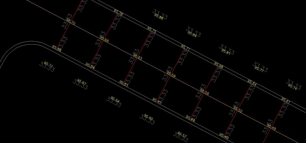

Hi everyone, I'd like to ask if you know a way to copy the contents of the text in yellow to the texts in gray in a simple way, or do you have any ideas to work around it, thanks for taking your time.
sample.dwg
Edited by Isaac26a
It appears that in image the 2 text overlap so it should be easy you get a selection set of one of the texts say yellow, then look for another text at that location, if found update the grey text. It would be a lisp.
In many of them you could say they overlap, but not in all of them, how can I search for a text in 'lets say a radius of 0.3'?, so far If I understand right
1. I should make a selection set of the texts in yellow (different layer and color, so should not be a problem)
2. Make a selection set of the texts in gray (so far ok)
How can I search for each one of the texts in gray from every insertion point of the texts in yellow?, then copying and replacing text wouldn't be much of a problem, and make the loop.

Thanks dan20047, but I don't see how this can help me, I actually do it kind of manually, (created a lisp) to pick one by one, pick the source and pick the destination and the destination text is replaced by the source text, but it takes time.
Still working on the lisp to achieve it, if I have it soon I'll post it so you (all) can help me make it faster, thanks.

Thanks Steven, finally finished my lisp and it's working, now does anyone have a better idea to improve it?

You have many overlapping texts in many places so its better to overkill the duplicates.

Well I tested the programs in a much larger scale (about 1550) text for each selection set and the results were
Tharwat's took  0:16.27
Mine  took          2:50:15
Mhupp's gives me an ; error: too many arguments wich I couldn't find where it is, as I see it, has a better improvement than mine
Bigal's didn't knew how to adapt it, maybe I should keep studying lisp wich I will, but at the moment don't know how

Yes, Thanks for the correction, I tested your code with the correction, and It took 1:16.88 wich is almost half of the time that mine took, I'll study the mods both of you made, so I can apply it to other programs, and keep improving. Thanks again for your help.
Here is another way .. checks that there is something within a distance of 1.5 ( based on the sample drawing ). Should be fairly fast 🍻
