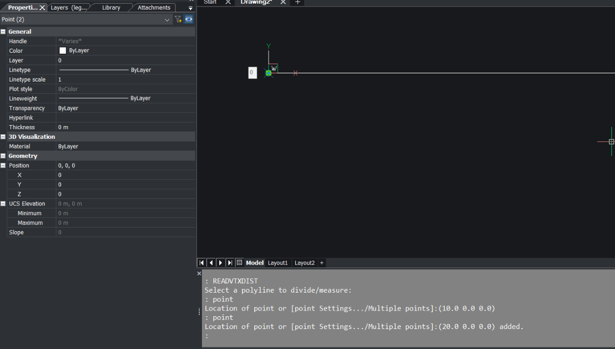

@DDS-NCorette
Hi.
I've tried to run the lisp but I'm getting all the points at the polyline start...(see attached screenshot and the TXT input file I'm using)

If you look at these 2 lines of code
(setq ln (read-line f)) ;reads a line of a text file
(setq pt (vlax-curve-getPointAtDist plineo (atof ln))) ; geta a point at distance ln
So you can only have a single number (atof 10 0 0) will not work

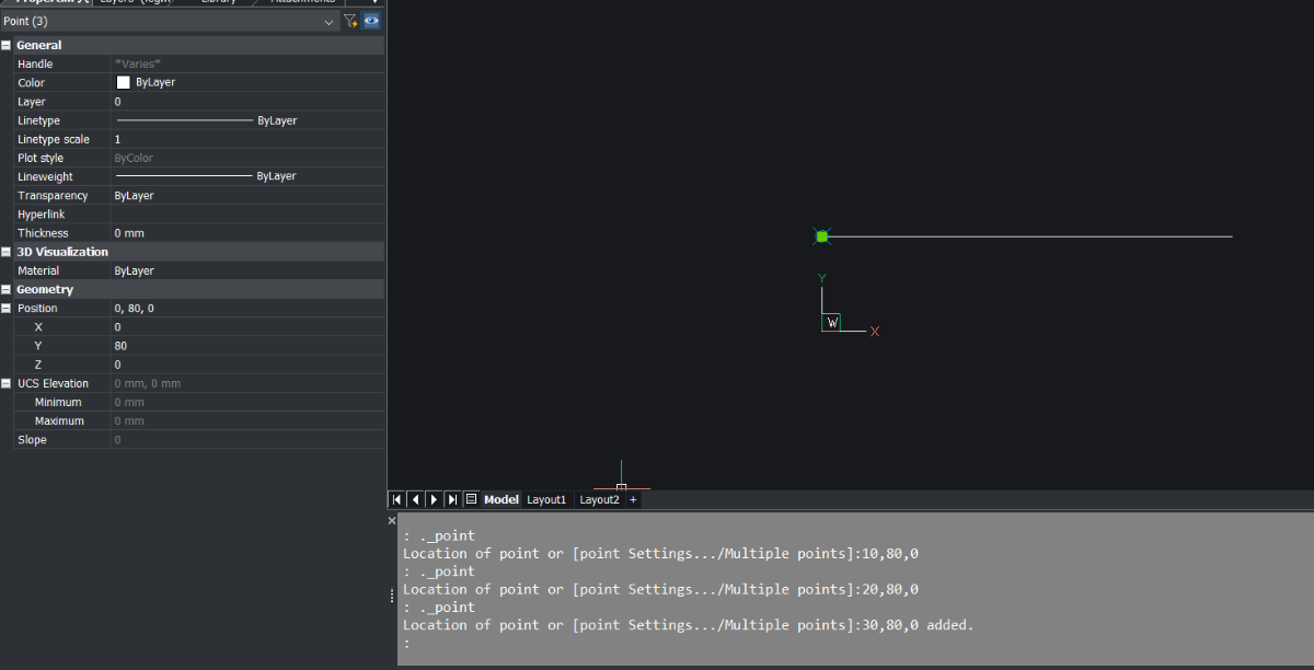

@BIGAL
I entered in the command line (command "point" "10,0,0") and it worked,
so I've made a small change to the lisp:
 (setq pt1 (strcase (strcat (rtos (car pt) 2 0) "," (rtos (cadr pt) 2 0)  "," (rtos (caddr pt) 2 0))))
 (command "._point" pt1)
and I'm still getting the same resault Although this time the points come's in the right format, see attached screenshot.

Worked for me maybe turn osnap off.
Edited by BIGAL
Yes,that was the problem... 🙂
I've disabled the OSMODE and it worked.

I think you can disable the Osnap temporarily by adding "_non" to the command statement.
(command "._point" "_non" pt1)
