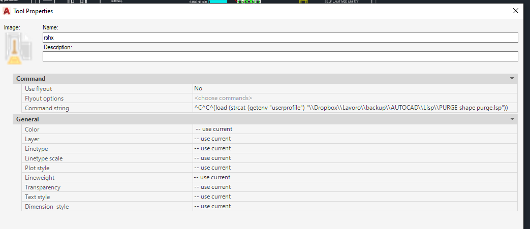

mhupp Posted November 15, 2021 Share Posted November 15, 2021 (edited) ^C^C^(load (strcat (getenv "userprofile") "\\Dropbox\\Lavoro\\backup\\AUTOCAD\\Lisp\\PURGE shape purge.lsp")) This only loads the lisp into AutoCAD. It doesn't run the lisp. you need to look at the start of the lisp for something like (defun C:RSHX () or what ever the command is. from there you can do two things. either type the command into the command prompt to run it. Or have this at the end of your lisp so when it loads it will automatically run itself. (C:RSHX) Example (defun C:test () (prompt "\nThis is a test") (princ) ) (C:test) Edited November 15, 2021 by mhupp Quote Link to comment Share on other sites More sharing options...

Steven P Posted November 15, 2021 Share Posted November 15, 2021 I think mhupp might have confused you, but that's OK. Your original command ^C^C^(load (strcat (getenv "userprofile") "\\Dropbox\\Lavoro\\backup\\AUTOCAD\\Lisp\\PURGE shape purge.lsp")) loads into memory all the LISP routines saved within the file "PURGE shape purge.lsp". There might be one, there might be a few. Next step would be to open your file 'PURGE shape purge.lsp' and look through it (or do a 'find') for the start of each function, which will typically start with "(defun c:" until you find the function you want to run. Replace mhupps example (C:RSHX with the name of your function and not his example and try that. Th part after the 'c' is the name of the LISP function and you will need to use (c: +[LISP name] ) 1 Quote Link to comment Share on other sites More sharing options...

mhupp Posted November 15, 2021 Share Posted November 15, 2021 23 minutes ago, jim78b said: Ok sorry me for don't understand. But only your edit code in command line prompt don't give me any message of load lisp file Yes @Steven P probably didn't explain it properly. 1. ^C^C^(load (strcat (getenv "userprofile") "\\Dropbox\\Lavoro\\backup\\AUTOCAD\\Lisp\\PURGE shape purge.lsp")) only loads the lisp. 2. Loading a lisp by default doesn't produce a message by default 3. if you already have the lisp loaded you only need to run the lisp then and should either be typed in the command prompt or ^C^C _lispcommand if you want just upload your lisp file and Steven or I will fix it. 2 Quote Link to comment Share on other sites More sharing options...

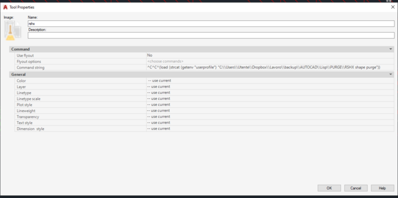

jim78b Posted November 15, 2021 Author Share Posted November 15, 2021 (edited) MY LISP FILE WORK WELL IF I USE IT WITH AUTOLISP WINDOW, but i want use it when i want throught a command tool bar button, i think wrong type folder.thanks for patience ^C^C^(load (strcat (getenv "userprofile") "C:\\Users\\Utente\\Dropbox\\Lavoro\\backup\\AUTOCAD\\Lisp\\PURGE\\RSHX shape purge")) Edited November 15, 2021 by jim78b Quote Link to comment Share on other sites More sharing options...
jim78b Posted November 15, 2021 Author Share Posted November 15, 2021 hello i managed to make it work, thank you all from my heart! (LOAD "C:/Users/Utente/Dropbox/Lavoro/backup/AUTOCAD/Lisp/PURGE/RSHX.lsp");RSHX; many thanks 1 1 Quote Link to comment Share on other sites More sharing options...
