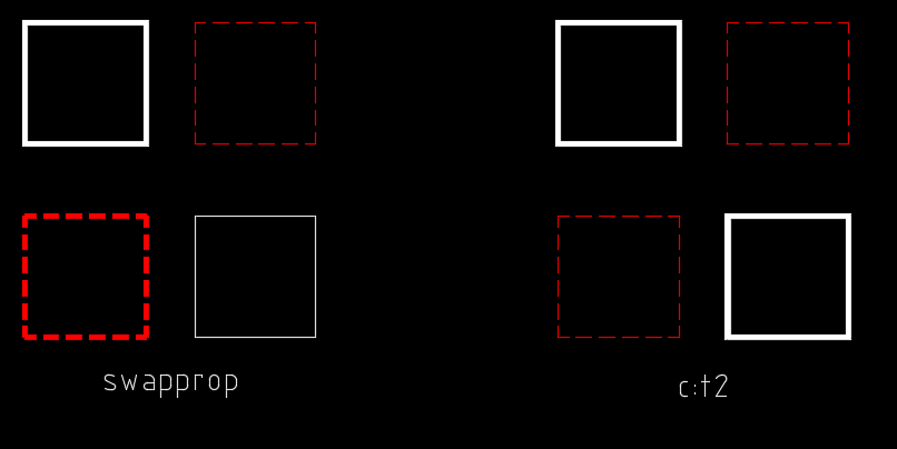

Hi, after several searches, I could not find a method or a lisp to swap the properties of two objects (layer, color...).
The easiest example would be between two lines or polylines, but even this search was unsuccessful.
If I have two lines to which I need to reverse the properties, I make a copy of both, and exchange the properties with the matchprop command, then delete the copies.
Is there a way to bypass the useless set of copy and delete commands?
Greetings
You could try entget the 2 objects, copy the DXF group code values for the properties you want to swap, and entmod the objects putting in the new values?
Saturday here.... CAD is off so can't do anything to check but if you have some time and google it is all out there somewhere
just cut copy pasted something together but google probably gonna find something looking like this :

  • Like 3
Nice one Grrr , glad to see you're still into lisping 👍
Something I do a lot in my workplace too. I made subfunctions for the general properties only though, so it's not exactly as advanced as matchprop:
(defun c:swapprop ( / ent1 ent2 getobject)
    (defun getobject (msg / ex)
        (while
                (setvar "errno" 0)
                (initget "Exit")
                (setq ex (entsel msg))
                (cond
                    (   (= (getvar "errno") 7) (princ "\nNothing selected."))
                    (   (member ex '("Exit" nil)) nil)
                    (   (not (setq ex (car ex))))
        ex
    (and
        (setq ent1 (getobject "\nSelect first entity <exit>: "))
        (setq ent2 (getobject "\nSelect second entity <exit>: "))
        (mapcar 'JH:ModifyProperty (list ent1 ent2) (mapcar 'JH:EntityProperties (list ent2 ent1)))
;; JH:EntityProperties --> Jonathan Handojo
;; Returns the general properties of an entity.
;; ent [ename] - entity
(defun JH:EntityProperties (ent / get)
    (setq get (entget ent))
    (mapcar
        '(lambda (a)
                (cond ((assoc (car a) get)) (a))
            (62 . 256)
            (8)
            (6 . "ByLayer")
            (48 . 1.0)
            (370 . -1)
            (39 . 0.0)
            (440 . 0)
;; JH:ModifyProperty --> Jonathan Handojo
;; Modifies the properties of an entity from an DXF association list
;; lst [list] - an association list of properties to modify
(defun JH:ModifyProperty (ent lst)
    (entmod
        (append
            (mapcar
                '(lambda (a / asc)
                    (if (setq asc (assoc (car a) lst))
                        (progn (setq lst (vl-remove asc lst)) asc)
                        a
                (entget ent)
            lst
Edited by Jonathan Handojo

I'm not sure if Johathan's version will work as intended because if you mod ent1 and then mod ent2 ... (setq a 1) (setq b 2) -> (setq a b) (setq b a) -> a = 2 , b = 2
If OP has to do a lot of swapping maybe this one is more 'fluid'

Well, if you don't try, you won't know.
I had this questioned in my head a couple times too, then our legend taught me something valuable that I kept on exploiting. Mapcar would evaluate any lists first prior to executing the lambda. Therefore, mapcar 'EntityProperties will be fully executed first before 'ModifyProperty. And then later I found out that this is also the case for other similar functions such as vl-some and vl-every. Reference is in here while I was toying around with Ish: https://www.cadtutor.net/forum/topic/64451-request-lisp-command-that-can-quick-swap-text-between-two-objects/page/2/?tab=comments#comment-580485
Plus, if we're talking MATCHPROP, does rotation, insertion point, and scale fall under the category? You wouldn't select two blocks and expect them to be rotated, swap positions, or scaled up, right? Or select two texts and expect their texts to be modified... I tested your t1 a few hours ago between two texts of different rotations and they both rotate. I haven't tried t2 though.
To be honest I just looked at (p)linewith actually but that's easy enough to fix / add.
I added a flog of (easy to read) props to a list so OP can decide which ones are important and which ones are'nt. You could of cource add a dialog with toggles for all the props you want to include but before you know it you are re-inventing the (matchproperty) wheel. Most of my app's are 1% core code and 99% dialog and error checking.

Certainly your code would definitely be the more practical one, given that mine would only match the general properties of any entity and nothing else (which was always my intent to begin with in the first place). At least in my workplace, that's more than enough, but it was also a challenge for me to try and avoid using vlax approach if possible because originally I created those subfunctions to perform the AutoCAD MATCHPROP command in reverse... by first selecting the destination objects (which could potentially be thousands of objects through select similar or some dirty ssget methods), and then the source. So using vlax approach would take a bit of time, and I thought just the general properties was enough for me. I just thought I'd share a bit of how I do stuff as well in here, but of course your code works just as great... certainly better.
nah , its not a race which one is better , many roads lead to Rome , its just finding what works best for you (or in this case for our silent OP 🤐) because only (p)lines are mentionend here (for now) and also finding the balance between investment and return in turns of coding-time and yield. Bigal usually has a good instinct for the balance between sense and nonsense where I sometimes can go over the top in the hope one day I get my investment (in time) back. I have created some great appies in the past for my co-workers that nobody uses because they say , great but too complicated , but now you can do my work in half the time 😁 so now I code most of the time for my 3 best friends , me , myself & I 🤣
Thank you all! All the lisp are great! for what I have to do, those of Jonathan Handojo and RLX's are the most immediate, but surely I will also use that of Grrr!
