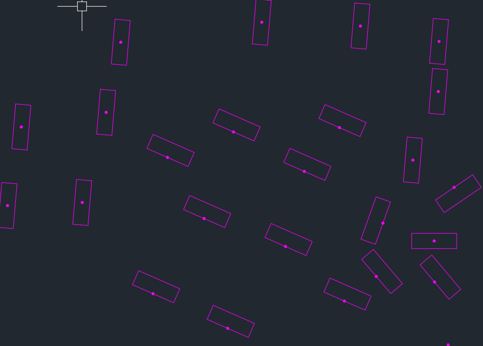

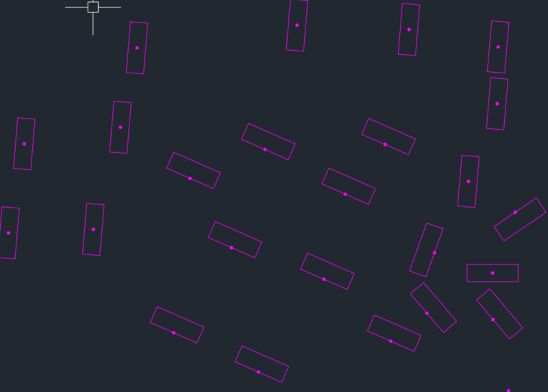

@mhupp I do  for the circle & hatch make them a block, after i tested have error. Can you help me edit? image.thumb.png.702b003581566f3747be4ab03bb89b9f.png
Your Base point for the block is mid of circle? looks like it worked on some but not others?
Forgot the "_non" when feeding points to copy command.
I think its a bug but working as intended. If your zoomed out even tho your telling AutoCAD the points it will snap to nearest objects like shown.
I think this happens even if you set 'osmode to 0.
I have updated my code should work now.
