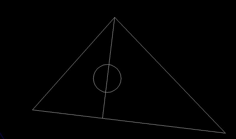

BIGAL Posted February 20, 2009 Posted February 20, 2009 Ok here is the maths answer As you can see the height of a point can be calculated from the other 3 pts if using lisp pick Pt1 Pt2 Pt3 Pick actual Pt. make Pt1 top of traingle you know the angle of pt to Pt1 so can calculate new intersecting Pt then work out its level then work level to circle based on Pt1 Quote
badien Posted February 21, 2009 Author Posted February 21, 2009 Thanks BIGAL for you helps, could you explain a little more in details. In my opinion, if we can get z co-ordinate of pt from 3 points pt1, pt2, pt3, we have to create a plane equation from these points (pt1, pt2, pt3), from this equation we can replace x, y co-ordinates of pt into this equation and get z co-ordinate. Is that right or wrong? Help me!! All your time is much appreciated! Quote
CarlB Posted February 21, 2009 Posted February 21, 2009 Quote Is that right or wrong? That's right http://mathworld.wolfram.com/Plane.html Quote
Charles Roberts Posted February 21, 2009 Posted February 21, 2009 Here is more detail: Equation of a plane Ax + By + Cz + D = 0 where vector [A,B,C] is normal to the plane, (x,y,z) is a point on the plane, D is a constant. To find the normal, calculate the vector cross product of two triangle edges such as pt1->pt2 and pt1->pt3 and normalize the result to length 1. Now you can calculate the plane constant D since any point that is on the plane can be used (you already have three: pt1, pt2, or pt3). Solve the above for z: z = (-Ax - By - D) / C A,B,C,D are known, x,y are the 2D coordinates for the unknown point, and z is the unknown elevation you are trying to find Quote
