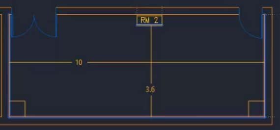

I think I get what you want in second part of your request...
In newer versions of AutoCAD, it is implemented new functionality of quick measure command, but AFAIK that's just visual effect - I don't know if those dimensions can be placed directly in DWG...
Look this :
https://videos.autodesk.com/zencoder/content/dam/autodesk/www/products/autocad/fy21/features/videos/quick-measure-video-v2-1920x1080.mp4

Here, I've coded (c:quickmeasure) tool so that it can be used in any version of AutoCAD/BricsCAD...
For now you'll have to be satisfied and with this functionality - it uses ordinary (grread) with no GrSnap implemented - even built-in command IMHO don't have this supported and beside this, how would you see changes if OSNAPs are functioning... Nevermind, if there are more time, perhaps someone may chime in like Mr. Lee Mac (once I got critics from him for using GrSnap, so maybe author himself would do implementation)...

HTH.
M.R.

How do I use it?
When I start the program it says: *cancel* and its gone
But I can load it without errors
Edited by Philipp
