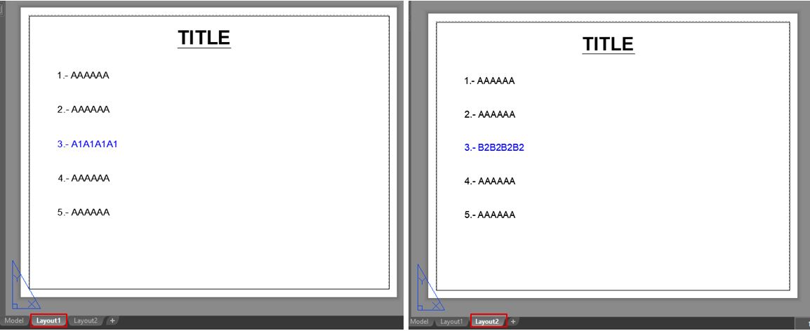

B2P Posted November 4, 2021 Author Posted November 4, 2021 Hi everyone, Thank you very much for the advice, graphically what I need can be better explained with the help of the following image: I have files with two or more layouts like the example in the image with a text that in some cases can say the same and in others not, but in all layouts it is located in the same position. In the example of the image it would be the text 3.- A1A1A1A1 on layout 1, and 3.- B2B2B2B2 on layout 2, what I'm looking for is a lisp or a script as recommended by BIGAL to help me delete the selected text in multiple files so you don't have to do it manually one by one. I hope I have explained myself better, in advance I appreciate all the help. Quote
BIGAL Posted November 4, 2021 Posted November 4, 2021 (edited) Ok pick the text any layout this returns the insert point then just do a erase in every layout. ; A little slow but works ; simple delete 1 text in a layout ; By Alan H Nov 2021 (defun c:1e ( / lay plotabs tabs tabname) (setq doc (vla-get-activedocument (vlax-get-acad-object))) (setq tabs (vla-get-Layouts (vla-get-activedocument (vlax-get-acad-object)))) (command "Pspace") (setq ent (entget (car (entsel "\nPick text ")))) (setq pt (cdr (assoc 10 ent))) (vlax-for lay tabs (setq tabname (vla-get-name lay)) (if (/= tabname "Model") (progn (setvar "ctab" tabname) (command "Pspace") (command "zoom" "e") (command "erase" pt "") ) ) ) (princ) ) (c:1e) Edited November 4, 2021 by BIGAL Quote
