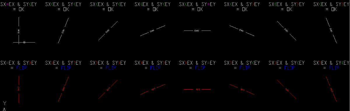

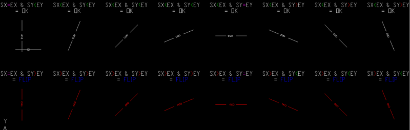

I have  attached an image that shows when not to flip and when to flip based on the x&y values.
In summary:
IF
StartX = EndX & StartY < EndY = No flip
StartX < EndX & StartY < EndY = No flip
StartX < EndX & StartY = EndY = No flip
StartX < EndX & StartY > EndY = No flip
StartX = EndX & StartY > EndY = Flip
StartX > EndX & StartY > EndY = Flip
StartX > EndX & StartY = EndY = Flip
StartX > EndX & StartY < EndY = Flip
Thank you for any input.
