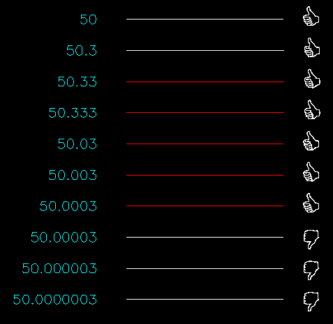

Manila Wolf Posted November 5, 2021 Posted November 5, 2021 I only have a minimal understanding of lisp, I am curious to know if somebody could adjust the code so that it only highlights the lengths that deviate from lengths that are drawn accurately to a whole number and numbers to one decimal place. i.e. Highlight lengths having 2 decimal places or more. examples: - Length = 50 (Code does not highlight) Length = 50.3 (Code does not highlight) Length = 50.33 (Code does highlight) Length = 50.333 (Code does highlight) Quote
mhupp Posted November 5, 2021 Posted November 5, 2021 2 hours ago, Manila Wolf said: Highlight lengths having 2 decimal places or more. Added another sub function to @ronjonp lisp count the decimal places of the length. (defun c:foo (/ _getlength _DecimalPlaces l s) (defun _getlength (e / ep) ;get lenght of entity (if (vl-catch-all-error-p (setq ep (vl-catch-all-apply 'vlax-curve-getendparam (list e)))) 0. (vlax-curve-getdistatparam e ep) ) ) (defun _DecimalPlaces (r) ;returns count of decimal numbers (1- (length (member 46 (vl-string->list (vl-princ-to-string r))))) ) (if (setq s (ssget "_X" '((0 . "~INSERT")))) (foreach e (mapcar 'cadr (ssnamex s)) (if (and (setq l (_getlength e)) (>= (_DecimalPlaces l) 2)) (entmod (append (entget e) '((62 . 1)))) ) ) ) (princ) ) Quote
