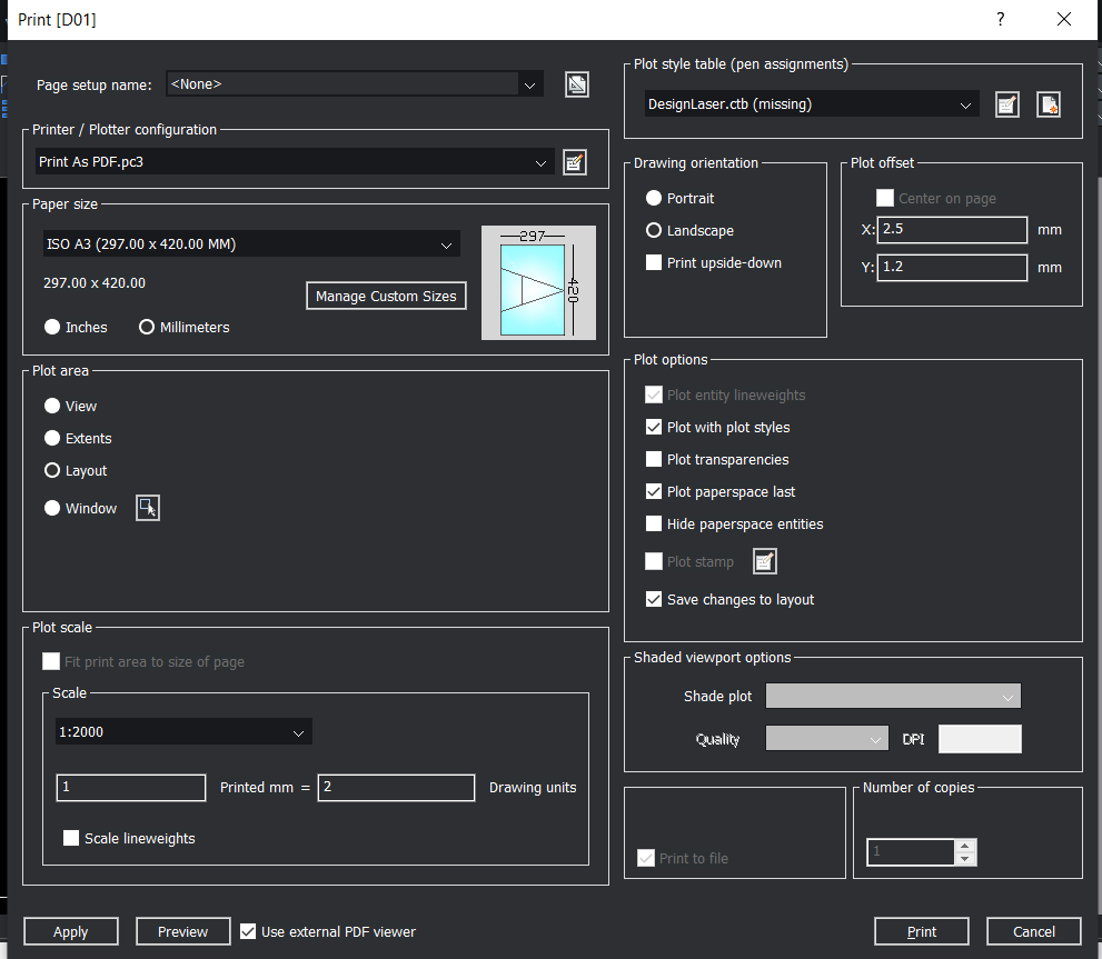

The print or plot should open the plot dialouge and just select correct choices. If it does not appear type filedia and set to 1. This is Bricscad but same for Acad. You can save setup top left and use apply so remembers for next time.

When I go to paper space tab. "LAYOUT 1". I right click and go to page setup manager. How do I get the right paper size sheet there?
Click Modify on the right of the Layout manager dialog,
Click Printer/Plotter on the left side of the next dialog box that pops up.  Then select your printer, or PDF.
Then click Paper Size a little lower down, and pick the desired paper size.  If you are printing to a pdf you can use almost any paper size, as long as the final destination of the file wants it that size.
Once you have all that hashed out, click OK and return to paperspace to adjust your viewport and scale to the paper size chosen.
You can't pick a paper size until the program knows what printer you will be using.

It sounds like you need a title block in the layout, start at 0,0 it can be as simple as a rectang say 48X36 true size. then a mview inside it. Then when you set the plot parameters the black rectang will match.
Thank yall for the help. I got it and I guess I had a few brain farts in between.
