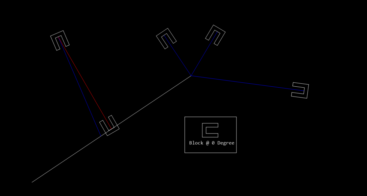

I have this block which needs to be placed at the end of  each dead end line.  Can it be automated , like selecting the block then selecting all the lines and blocks will be placed. thanks
If they are lines they would have to be drawn the same way.  The first point picked when drawing a line is always 10 the other endpoint will be 11.
Attached the red line is drawn from the center point of the white to the end of the blue line. that is why the block is backwards.
the rest of the lines were draw by picking the point not touching the white line first.
This is just a basic lisp to get you what you need. The block 0 degree needs to be like the one in the rectangle.

Its giving an error because my code uses lines to generate points. the blue "lines" in your drawing are polylines so points are not generated.  Error "2D/3D point: nil"
@ronjonp's code works but block needs to be rotated 180, scaled up by 8. then exploded and made a block again with new orientation and scale. see attached.
