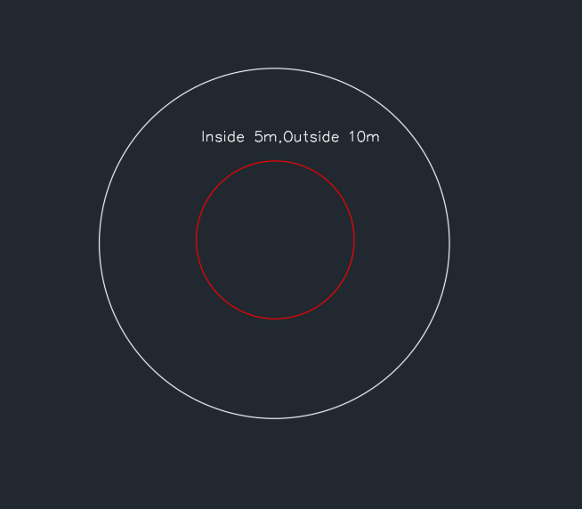

Alexv Posted October 16, 2021 Posted October 16, 2021 Hi all, I'm having an issue trying to create a Dynamic Block that scales in size according to the user's input value. For example, I have 2 circles, 'Inside' and 'Outside'. I hope to allow the user to change the scale of the 'Inside circle' and 'Outside Circle' independently by typing in a value. Then the values would be display in a label. Please see attached diagram of what I've just described. Is it possible to have a few preset options for the 'Inside Circle' and 'Outside Circle' so that the user can choose from? And also allow them to enter in custom size. How would I go creating such dynamic block? The diagram is just a quick drawing and doesn't work. Thank you and have a good day. Quote

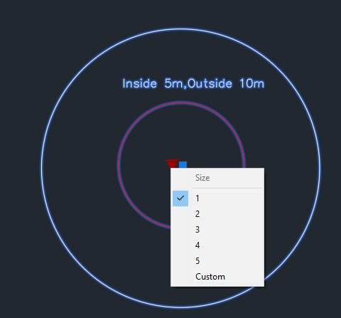

BIGAL Posted October 23, 2021 Posted October 23, 2021 (edited) Just make a dynamic block with rad1 rad2 for the circles say both 1 unit dia. The code above is missing a ( at start sorry. Fixed it and this is closer to what you want. In CIV3d can do TR6*3 which means a 6m tree with a 300mm trunk so i did what you want and would update a tree block. (if (not ah:buttscol)(load "Multi Radio buttons 2col.lsp")) (if (= ah:but nil)(setq ah:but 1)) (if (= ah:but2 nil)(setq ah:but2 1)) (setq lst1 (list "Select spread 1" "2" "5" "10" "12.5" "15" "other r1")) (setq lst2 (list "Select trunk" "0.3" ".45" "0.6" "0.9" "1.2" "other r2")) (ah:buttscol ah:but ah:but2 "Dual Circles" lst1 lst2) (setq ans1 (atof (nth ah:2col ah:butlst))) (setq ans2 (atof (nth ah:2col2 ah:butlst2))) You are lucky here is treedyn.dwg, How do you intend to match to a point ? Edited October 23, 2021 by BIGAL Quote
Alexv Posted October 23, 2021 Author Posted October 23, 2021 @BIGAL Thankyou so much Bigal, that works great! I'm going to play around with it and see if I could add a dynamic field text label that displays the trunk and canopy diameters. Will let you know how that goes. Thanks again everyone. Y'all the best! Quote
BIGAL Posted October 24, 2021 Posted October 24, 2021 For anyone else bedit the treedyn block and look at dynamic properties. Quote
