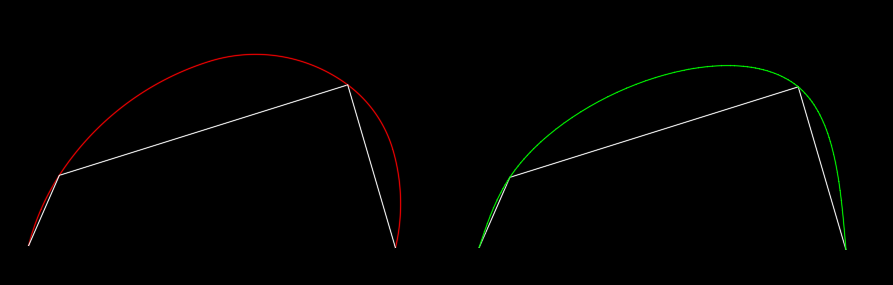

lrm Posted October 17, 2021 Posted October 17, 2021 Using PEDIT and FIT will convert the polyline to a series of arcs. Two arcs are created between each polyline vertex. The arc tangent will be the same where two arcs meet. That is, the curve will have a continuous its first derivative throughout its length. The result may deviate from the original polyline by quite a bit.. You may get a smoother result by using SPLINE and the FIT method specifying each of the 10 points for the spline's fit points. This will yield a spline with a continuous first and second second derivative, That is, a smooth function for the change in the change in slope as well as just the slope. By default, the curve between each of the points will be a cubic. The red curve below is the result of using pedit on the white polyline and the green curve is a spline. Quote
