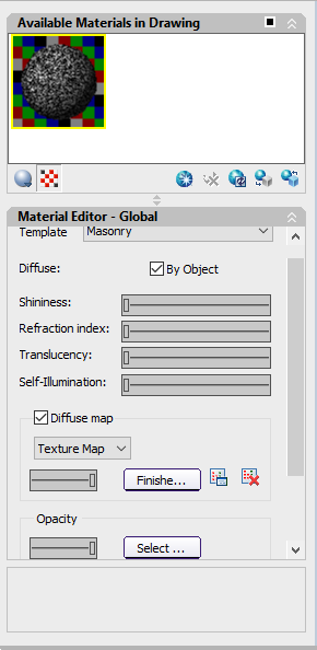

Berzerker Posted October 12, 2021 Posted October 12, 2021 (edited) I got me a new project and I wanted to add some materials to it so I could see what different things looked liked with different materials applied. Yeah, It didn't go so well. I picked a material and selected "Apply materials to objects", sounds simple. All of a sudden everything in the drawing gets this material. I don't get to pick anything, it just applies it to everything. I open the materials list: Can't get imgur to work images in attachments Select the material Then I get this: Image in attachments And when I do manage to get the paint brush to choose what to apply it to when I select it, it doesn't change anything. help Edited October 12, 2021 by Berzerker Quote
SLW210 Posted October 13, 2021 Posted October 13, 2021 I drag and drop the material on each object or use Material by Layer. You can also insert materials into the drawing and assign them in properties. Are you using AutoCAD 2007? Quote
Berzerker Posted October 13, 2021 Author Posted October 13, 2021 Hey nice to post with you again SLW210. Yes I'm still on 2007. I even assigned each object to different layers, turned layers off and on hoping it wouldn't affect them but it did. I will try the drag and drop but it should allow me to choose with the paint brush which objects I want to apply the materials to. I'll let you know what happens Thanks Quote

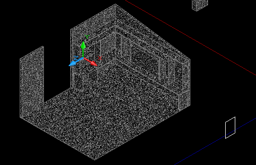

Berzerker Posted October 13, 2021 Author Posted October 13, 2021 (edited) Ok that didn't work. I'll open my materials list And if I choose texture map and select anything and try to apply it nothing happens And if I use Bump map and select a material as soon as I click the open button everything changes. I still get no choice what to apply it to. I've clicked everything and still haven't figured this out. Edited October 13, 2021 by Berzerker Quote
Berzerker Posted October 13, 2021 Author Posted October 13, 2021 (edited) OK I think I figured it out. I had to make a new material and name it what it was in the list then it showed up as a second material in my list. I could then select it and apply it to the different objects. Edited October 13, 2021 by Berzerker Quote
Cad64 Posted October 14, 2021 Posted October 14, 2021 On 10/13/2021 at 8:47 AM, Berzerker said: OK I think I figured it out. I had to make a new material and name it what it was in the list then it showed up as a second material in my list. I could then select it and apply it to the different objects. Hey Berzerker. Long time, no see. Looks like you already figured it out, but I remember having this same issue back when I used to do 3D work in Autocad. The first material acts like a global material and gets applied to everything, as you saw. So I always left that material blank and created new materials for each object. 1 Quote

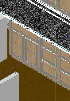

Berzerker Posted October 20, 2021 Author Posted October 20, 2021 (edited) What's up Cad64. Yeah I kinda thought for a second and it made sense. It was putting the default layer on it that I was changing. Yes f700es I have simlab composer but I use it to get an idea so I'll just quick render it in AutoCad. I'm not a everyday user of AutoCad so in between using it i have to remember somethings again. I got a question. When looking at the objects I get bleed through (I guess that's what you would call it). I can see what's underneath other solid objects. I can understand it while in wireframe but if it's a 3D solid I shouldn't see what's below a solid. Is there a setting to fix this ? You have to look close but those straight lines are what's below. Edited October 20, 2021 by Berzerker Quote
Cad64 Posted October 21, 2021 Posted October 21, 2021 I'm not sure which lines you're referring to, but you could try using one of the other visual styles and see if that helps. You could also try enabling or disabling hardware acceleration. And check to make sure you're using the latest driver for your graphics card. Quote
Berzerker Posted October 21, 2021 Author Posted October 21, 2021 Got the latest drivers. I believe I just read something on hardware acceleration but I turned it on because it was doing it, so that's not it. I know if you draw an object and extrude it (Make it a solid) it will keep the edge lines (the lines you see at the corners and edges) so you can pick that object. Those are cabinets and if you look at the bottom doors you can see the shelves that's behind the door and you can see the cabinets themselves under the counter top. Those straight lines are the shelves and cabinets. I shouldn't be able to see a shelf behind a door, should I ? Quote
Cad64 Posted October 21, 2021 Posted October 21, 2021 No, you shouldn't be seeing those lines. Maybe it has something to do with the materials you're using or the visual style? I'm not really sure. Maybe try switching to the Shaded visual style. Your materials won't be visible in Shaded mode, but at least you can see if the lines disappear. Quote

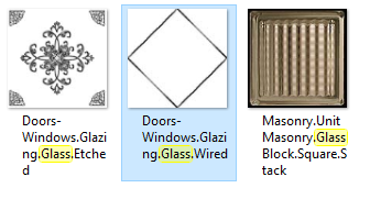

Berzerker Posted October 22, 2021 Author Posted October 22, 2021 (edited) I was shocked to find out that there is no regular clear glass in the 2007 library. I also found a materials library but it wouldn't install (something about wrong version). When I checked the properties of one of the materials it was just a .jpg file. What gives here ? I know I can just make the glass but that's not the point. I'm sure in later versions there is glass. I get three glass materials when I search the materials folder and none of them are just plain glass. Is there another materials library that you can download for older versions. This is all I got. It kinda reminds me of the chrome material that it doesn't have either. Edit: it took me about 5 seconds to create it ? Edited October 22, 2021 by Berzerker Quote
Cad64 Posted October 22, 2021 Posted October 22, 2021 There's a difference between textures and materials. A texture file would just be a simple .jpg image file. A material controls how the texture appears on the model, like it's reflectivity, specularity, color tint, roughness, etc. That's why the material library you found won't load and tells you it's the wrong version. It was probably created for a newer version and won't work in 2007. As for the 2007 version, yeah, I remember the materials library was pretty minimal. Newer versions have a lot more materials. And no, I don't know of any other libraries you can download for older versions. You will just have to make your own materials. Or take your model into Simlab. Quote

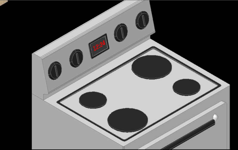

Berzerker Posted October 23, 2021 Author Posted October 23, 2021 Rendered in AutoCad I think I'm getting better Stove Quote

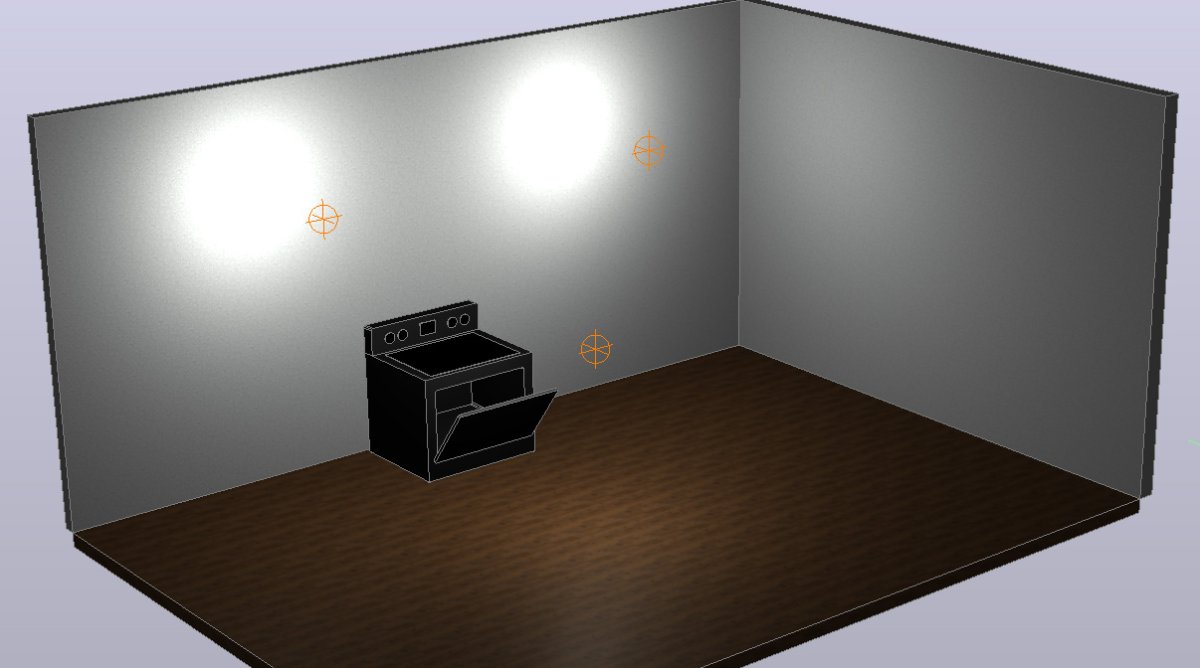

Cad64 Posted October 24, 2021 Posted October 24, 2021 The model is looking pretty good, but your burners and cylinder knobs look really faceted. If you set the FACETRES variable to 10, that should smooth out the cylinders and make them look nice and round. For rendering, I would suggest turning Perspective on. I decided to slap together a quick and dirty scene to show what can be done for presentation purposes. I turned Perspective on, added a floor, two walls and 3 point lights. Nothing fancy, just a quick little environment setup to add a little realism to show off your model. Hope that helps. 1 Quote
