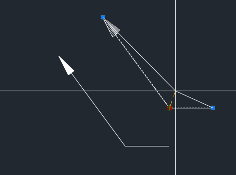

Something when picking an object's point, the cursor UCS was changed to different UCS as shown below.
1157422369_SampleofUCSchange.png.263d39157b0d4e8ab09b29ef4d67fbb5.png106830698_SampleofUCSchange2.png.324bdd2fb0448f52dd109dd02c9731a1.png
Sample drawing is attached. I have no idea why it is happened to objects. (maybe the z value?)

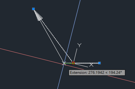

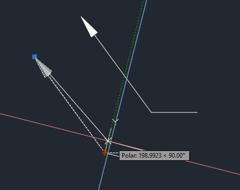

I use UCS->Object then select the horizontal segment.
After that, I use Ctrl + C to copy the object and UCS->World and paste.
1479588212_ObjectsnappointUCS_1.png.4b56e50c3109625a205f0b05850407f5.png1999322839_ObjectsnappointUCS_2.png.b3a79c9a010d2235b77edeedb547e7f4.png
The object's point resume normal.
Can this process done by Autolisp?
If you list your leader, you will see it is curiously twisted, which results in the UCS also being curiously aligned.
