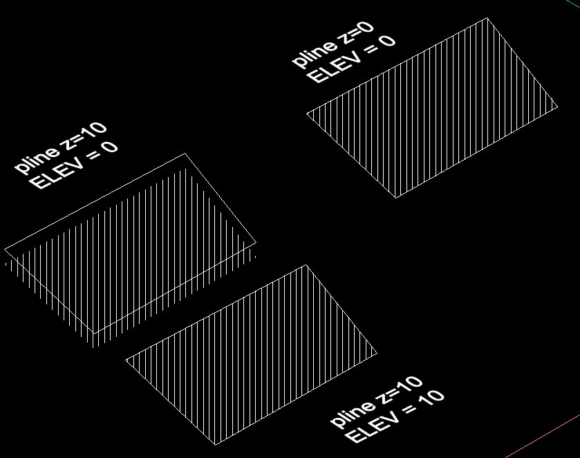

If the plines vertices are all at 1 elevation then why not use "ELEV" its built in.
