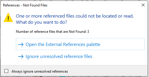

handasa Posted October 1, 2021 Share Posted October 1, 2021 Hello Everyone is there a way to suppress this dialogue message of unresolved references at opening the drawings by autolisp. when the drawing is opened by ObjectDBX method it fails to open due to this problem. i want to suppress this problem from the code not by checking the box of "always ignore unresolved references" i tried to change "xrefnotify" variable with no hope to suppress this dialogue. thanks Quote Link to comment Share on other sites More sharing options...

handasa Posted October 1, 2021 Author Share Posted October 1, 2021 (edited) 1 hour ago, ronjonp said: Strange, I always thought that XREF's were not loaded in ODBX sessions. ATTACHED BELOW A DRAWING.IF YOU CAN HELP.THANK YOU ANYWAY the problem came when i try to use "DXFOUT" method on the drawing (vlax-invoke-method dbdoc 'Dxfout dxf) with this error error: Automation Error. Description was not provided CA1712-M438.DWG Edited October 1, 2021 by handasa Quote Link to comment Share on other sites More sharing options...
ronjonp Posted October 1, 2021 Share Posted October 1, 2021 Here's a start of issues: Quote Command: AUDIT Fix any errors detected? [Yes/No] <N>: Y Auditing Header Auditing Tables Auditing Entities Pass 1 Pass 1 193000 objects audited Auditing Entities Pass 2 Pass 2 24500 objects auditedAcDbBlockReference(38B36) BTR Id invalid AcDbBlockReference(38B36) could not be repaired. It will be Erased. AcDbBlockReference(38B37) BTR Id invalid AcDbBlockReference(38B37) could not be repaired. It will be Erased. AcDbBlockReference(38B38) BTR Id invalid AcDbBlockReference(38B38) could not be repaired. It will be Erased. AcDbBlockReference(38B39) BTR Id invalid AcDbBlockReference(38B39) could not be repaired. It will be Erased. AcDbBlockReference(38B3A) BTR Id invalid AcDbBlockReference(38B3A) could not be repaired. It will be Erased. AcDbBlockReference(38B3B) BTR Id invalid AcDbBlockReference(38B3B) could not be repaired. It will be Erased. Pass 2 157900 objects auditedAcDbBlockReference(5CD96) BTR Id invalid AcDbBlockReference(5CD96) could not be repaired. It will be Erased. AcDbBlockReference(5CD97) BTR Id invalid AcDbBlockReference(5CD97) could not be repaired. It will be Erased. AcDbBlockReference(5CD98) BTR Id invalid AcDbBlockReference(5CD98) could not be repaired. It will be Erased. AcDbBlockReference(5CD99) BTR Id invalid AcDbBlockReference(5CD99) could not be repaired. It will be Erased. AcDbBlockReference(5CD9A) BTR Id invalid AcDbBlockReference(5CD9A) could not be repaired. It will be Erased. AcDbBlockReference(5CD9B) BTR Id invalid AcDbBlockReference(5CD9B) could not be repaired. It will be Erased. Pass 2 193000 objects audited Auditing Blocks 771 Blocks audited Auditing AcDsRecords Total errors found 12 fixed 12 Erased 12 objects 1 Quote Link to comment Share on other sites More sharing options...

BIGAL Posted October 2, 2021 Share Posted October 2, 2021 Did you ggogle pretty sure there is an option about disabling messages, found some about proxy objects and others, but not xref's. Quote Link to comment Share on other sites More sharing options...
handasa Posted October 4, 2021 Author Share Posted October 4, 2021 On 10/2/2021 at 8:28 AM, BIGAL said: Did you ggogle pretty sure there is an option about disabling messages, found some about proxy objects and others, but not xref's. i googled it with no hope Quote Link to comment Share on other sites More sharing options...
