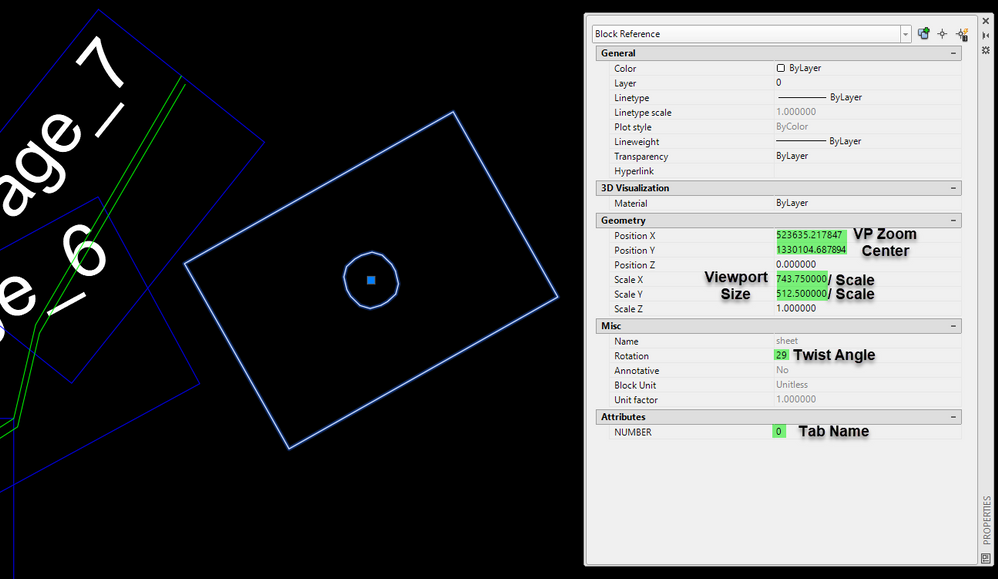

Auto Rotate Block View Frame to match Viewport

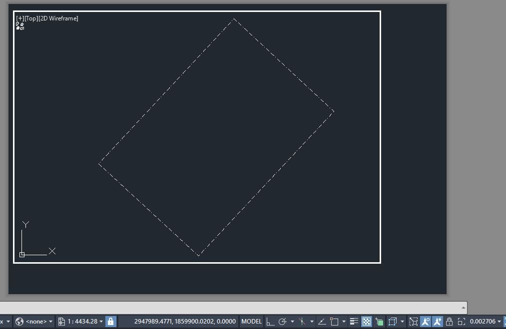

The below is a part of a routine which allows to copy the current layout tab a multiple of times, then it would go through each layout and activate the viewport, turn on a layer number,  to zoom extents and set the scale, then go to the next layout tab and do the same.
I am trying to figure how to auto rotate the viewport to match the block view frame, then go onto the next.

I stumbled upon this post, But was not sure how to get the rotation piece to work.

Your using (vla-put-customscale have a look at also  (vla-put-twistangle
